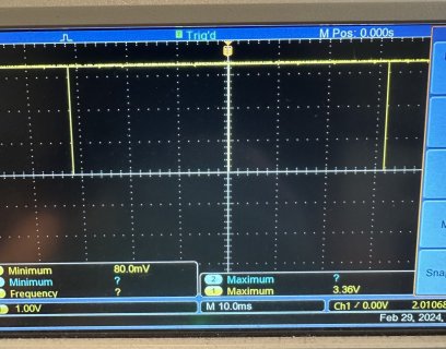

i had been prototyping a small board with a few dac8568 and my teensy 4.1 and all was well but when i had a custom pcb produced i noticed individual cs lines on all dac's toggle despite it not being communicated too, im putting it down to inteference on a pcb level but just wanted to see if any users experience cross talk on cs lines before...

Can you give us more detail? You said "noticed individual cs lines on all dac's toggle". Can you describe how you noticed? Did you use an oscilloscope to observe the signals? If so, can you show us the screen? Or if you're not directly observing the signals but rather inferring they must all be toggling, can you describe the actual things you observed with your eye or other senses? Signal quality issues are tricky and even very small details can really matter.

the toggles look quick and appear on all cs lines, ive attached a photo.

Just wondering, this looks a bit too ideal (full 3.3V scale, pulse shape) to be a crosstalk. Have you checked the CS lines with a continuity tester if there is a short between them and/or a different signal?

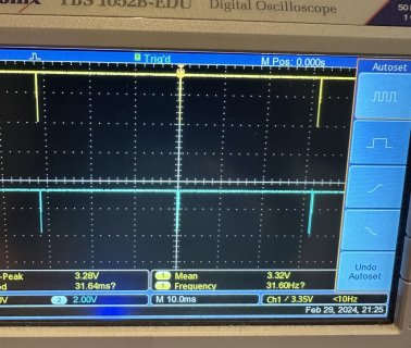

so strange, i tried a pull up res on all cs lines and that did not help i then cut one cs line trace completely and bodge wired directly with 100 ohm res in series and still not working!
Difficult to understand that scope picture, as it doesn't show the time scale. It's also only 1 waveform. Normally for diagnosing cross talk problems, you would connect 2 channels... one of the aggressor signal and one to the victim signal (or if more than 2 channel scope, to multiple victim signals to see whether they are affected similarly or differently, but you can do this same with 2 channel and patience by just repeating the measurement for each victim signal). And normally you would capture on a "zoom in" time scale to see the shape of the rising or falling edges.
Please turn the horizontal knob to a shorter time scale. At this slow time scale, we can see the waveforms repeat every ~32ms, but we can't see the detail within that short pulse. Cross talk is a high frequency effect. You can't possibly hope to diagnose it with this slow time scale.
all cs lines share the exact some waveform in time, it must be pcb design
If they look the same shape, then yes it's much more likely to a PCB design or build problem. Crosstalk will usually show rectangle shape on the aggressor (because it is a digital signal driven both high and low by transitors) and sharp spikes with quick roll off on the victim signals (because they're driven only by high frequency coupling through the capacitance between signals and then return they gradually back to normal after the rapid coupling event).
With power off, you might try an ohms measurement between the signals. If they're shorted together or connected by a part like a resistor, the ohms measurement should show it.
