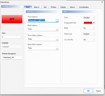

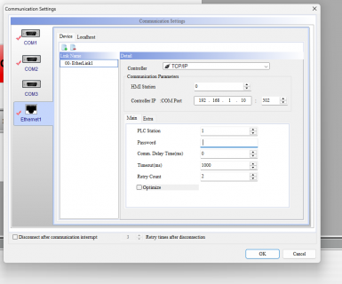

hello friends i have a teensy 4.1 with use of native ethernet over TCP IP protocol to communicate with DELTA HMI 100 series DOP-107WV . so when i try with teensy4.1 etherent to PC ethernet communication working . When i try DOP-107WV HMI ethernet to PC ethernet is working but when i DIrect connect Teensy4.1 Ethernet to HMI ethernet than communoication is not established . please help me if any solution .

above is code and below is the HMI setiing image

ok evreything is working now simple setting i have a miss in DOP HMI setting page i have to set controller ip same as teensy ip and local ip set to different in HMI. now both library work and i have receive and send data. Thnaks for help.
