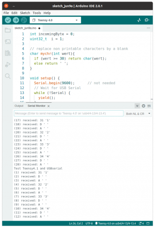

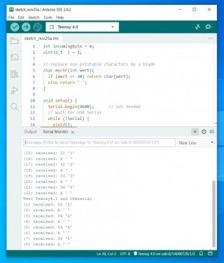

Teensy4.1 - reading from Serial Monitor of Arduino IDE
Note: You can still compile, just simply select the appropriate Teensy in the Tools menu as well as the port...
The issue far as I can tell limited to clicking on the drop down list.
You can now track this issue: https://github.com/arduino/arduino-ide/issues/1588
nvalid FQBN: not an FQBN: teensy:avr:teensyMM:usb=serial:usb=serial,speed=600,opt=o2std,keys=en-us
Compilation error: Invalid FQBN: not an FQBN: teensy:avr:teensyMM:usb=serial:usb=serial,speed=600,opt=o2std,keys=en-us

In IDE 2.0.1 I saved the new sketch and exited and restarted and same build fail.
Went to Board Mgr and seems I went 1.58b1 then to 1.58b2 and failed the same.
Went back to TD 1.57 and it fails there too. Seems some issue with updated IDE 2.0.1 reading the platform info?
Went to typical build from SublimeText
> It uses the TSET made FQBN string and worked using IDE 2's installed TD 1.57 and then again 1.58b2 when the board was updated in IDE2
Those build work of course - so somehow FQBN string fails with update to 2.0.1 - when presented properly nothing changed where 1.8.x cmd line builder uses installed TD files.
ALSO NOTE - once built the HEX on the T_4.1 runs fine and good using TYCommander and with that closed using IDE 2.0.1 SerMon with TeensyPorts it also works properly?
That shows T_4.1 is good and WIN USB is good - and even TeensyPorts can work?
I never did repro of initial problem as the update to 2.0.1 was installed and then IDE 2 cannot build.
Correct, picking from drop down menu: T_4.1 allows complete build.
>> Opps - walked away a couple hours before finishing prior post - did refresh and these posts on new page ...
Also: once uploaded this code worked fine with TeensySerial_SerMon - EXCEPT: I had to CLOSE and OPEN SerMon again before it triggered connect to T_4.1 and displayed the first line after while(!serial) waiting.

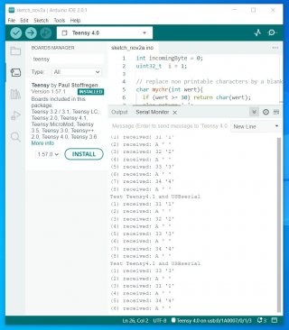

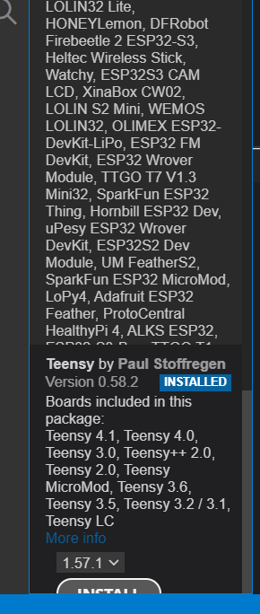

I've uploaded teensy-discovery 1.57.1 (which removes the extra identification properties which trigger issue 1588) and an updated package_teensy_index.json.
I do not know how to tell Arduino 2.0.1 to refresh package_teensy_index.json. Simplest thing might be to wait a day or two. I'm also not sure if it will offer an automatic update, or if you have to uninstall and reinstall the Teensy package from Boards Manager. Also not clear if Arduino 2.0.1 will stop the old discovery and start the new one without restarting the whole IDE (you'd think it should, but....)
Anyway, when Arduino 2.0.1 notices the updated package_teensy_index.json, and you remove and reinstall Teensy 1.57.0, you should see this:
Arduino IDE downloads the indexes on startup if it has been more than 4 hours since the last index download.
If you would like to manually trigger an index download sooner than than, you can use the "Arduino: Update Package Index" command:
  1. Press the Ctrl+Shift+P keyboard shortcut (Command+Shift+P for macOS users) to open the "Command Palette".
  2. Select the "Arduino: Update Package Index" command from the menu.
  3. Wait for the notification to show the index download process is finished.
The IDE only offers an automatic update if the installed Teensy platform version is older than the latest version available from the package index. This means you must make a new platform release in order to distribute a new release of a pluggable discovery or monitor tool via the Boards Manager update mechanism. In the event you don't have any changes to distribute for the platform itself, this is only a matter of copy/pasting the previous packages[*].platforms[*] entry in the package index file and bumping value of its packages[*].platforms[*].version key. From the user standpoint, the update will go quickly because the archive files are cached, so the only download will be teensy:teensy-discovery@1.57.1

Started IDE 2.0 - prior problem existed {p#28/29} - w/1.58b2
> grabbed PJRC JSON on startup
> Also did the @PerT explicit grab of JSON
Selected 1.57.0:
Tool teensy:teensy-tools@1.57.0 already installed
[B]Tool teensy:teensy-discovery@1.57.0 already installed[/B]
Tool teensy:teensy-monitor@1.57.0 already installed

Seems to have stuck with the "Tool teensy:teensy-discovery@1.57.0 already installed" - yet Uninstalled?
Same going back to TD 1.58b2:

What is the package index URL you have in the "Additional Boards Manager URLs" preference for Teensy?
I am using the production URL:
https://www.pjrc.com/teensy/package_teensy_index.json
and mine doesn't have a 1.58b2 release. I guess there is probably a different package index for beta testing.
Use File > Preferences to edit the addition boards manager URLs. Use https://www.pjrc.com/teensy/package_teensy_index.json (without "td_156").
I added 1.58-beta2 as version 0.58.2. Still only has support for Windows and Linux x86-64. Hopefully by using 0.58.2 it won't get offered as a default choice for anyone.
I'm probably going to delete the old "td_156" package index eventually. Keep 2 of them updates is beyond my maintenance threshold.

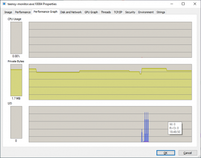

About the original problem, I can't reproduce it on Linux with Arduino 2.0.1 and Teensyduino 1.57.1.
I restored a disk image onto my Windows test machine and it's been stuck in a cycle of Windows Updates and reboots for the last couple hours. Going to image it again before installing anything.
Best guess at this point is it's probably a bug in the Windows version of teensy-monitor, since this works on Arduino 1.8.19 (which uses teensy-serialmon, not teensy-monitor) and teensy-monitor seens to work fine on Linux.

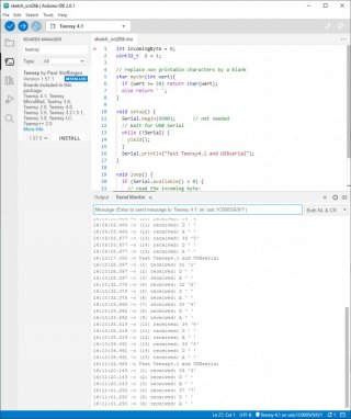

Updated my link in preferences (forgot that originally) and reinstalled 1.57.1 and the FQBN message went away. Reinstalled 0.58.2 - no issues.
Yep you are right every time I start 2.0.1 I get the message about updating libraries and boards - I always select later or install manually.

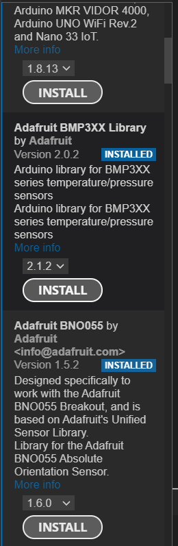

Didn;t see any library updates for SDFat though but that could be me.
The one thing I noticed is if I try to install board updates manually it does give me the option to install the updates individually:
Notice the blue line - I tried to select one board but they all highlighted and the install showed at the botton of the screen and is cut off - almost missed it.
It looks like this bug:
https://github.com/arduino/arduino-ide/issues/1591
I suspected that it would also occur with Boards Manager, but didn't manage to reproduce it there, so I only mentioned Library Manager in the bug report. But both use the same GUI code, so the fix for the Library Manager bug will fix the Boards Manager bug regardless.
The workaround is to increase the width of the side panel a little bit.
Thanks for response. Could very well be. Funny though when I go to library manager, I am not seeing that same issue:
oopps wrong image:
On the original lost data, I was able to reproduce the problem on Windows 10, but only after unplugging and reconnecting the cable a couple times. I couldn't get it to happen immediately after an upload.
I'm pretty sure this is my fault in teensy-monitor.exe (Windows only), not a bug in Arduino 2.0.1, (probably) not an issue on the Teensy side. Will dig into the code soon...
Installed teensy-discovery 1.57.1
and ran the tests 1 <CNTR + ENTER>, 2 <CNTR + ENTER>,3 <CNTR + ENTER>, 4 <CNTR + ENTER>, 5 <CNTR + ENTER>, then disconnect and reconnect.
It started off well but after a few disconnect/reconnects, the missing responses showed up again. On the screenshot above you can see that the responses on 1, 2, 4, 5 & 6 are missing.
Paul

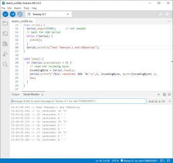

Upgraded this afternoon to Arduino IDE 2.0.2, but the problem persists. Sort of expected this after PaulStoffregen's remark above.
Using Process Explorer > teensy-monitor.exe > Properties, I see the following for I/O when I entered 0 <ENTER>, 1 <ENTER>,....8 <ENTER>, 9 <ENTER> to be send out by Serial.printf():
The 4 out of 11 received messages correlate with the Process Explorer I/O graph.
Paul
Looking at this issue again today. Can confirm, reproducible with Arduino 2.0.2 on Windows. Can't reproduce it on Linux. Haven't tried MacOS yet.
Ok, I believe I have a fix for this problem on Windows. If anyone is still watching this thread, please give this teensy-monitor.exe a try. Does it fully solve the problem on your machine?
On my Windows install, the location was C:\Users\{username}\AppData\Local\Arduino15\packages\teensy\tools\teensy-monitor\1.57.0.
  • teensy-monitor.zip
After testing, I believe you fixed it!
Did about 10 disconnects-reconnects, sent a lot of short and long strings and it never missed a single reply in the serial monitor window.
Thanks,
Paul
Gave it a try using 1.58-beta2 as well and seems to be working as @PaulS mentioned. Used Arduino 2.0.2.
