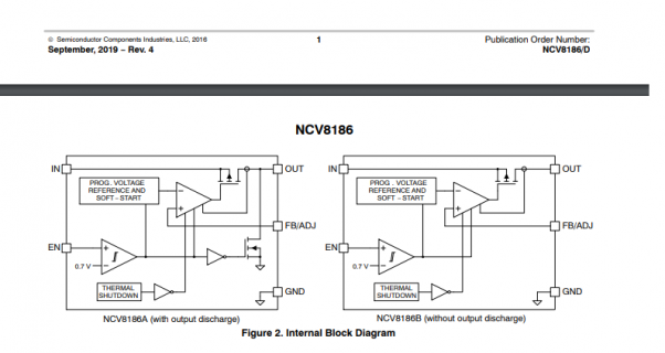

However, the 3V3 LDO regulator (U4, which was TLV75733P and now is NCV8186AMN330TAG) has an enable input. driven by the Teensy. When that pin is low, the LDO not only turns off, but also shorts the 3V3 rail to GND, thinking that it is discharging just capacitors out there. But what happens if you push 3V3 externally on the output of the LDO U4? Think a scenario where you had the Teensy4.1 powered externally with a 1+ Amp capable 3V3 source, and have a battery on VBAT, and have it in sleep mode with PMIC_ON_REQ low, and then plug in USB with 5V... Or think what happens if you push the Teensy into sleep mode by pressing its switch for x seconds... Note the new NCV8186AMN330TAG shorts its 3V3 output to GND when disabled, the NCV8186BMN330 does not, and the TLV75733P does it via an on-chip resistor. With NCV8186AMN330 the exposure is high and I think you may kill it eventually...
Indeed it is shown as a N-channel mosfet shorting to GND in Figure 2 of OnSemi's datasheet. But in Table 4 on page 3 the Output Discharge Resistance is specified as 34 ohms. It's not just a fraction of 1 ohm, as you might expect from a discrete N-channel mosfet. I doubt there's actually a 34 ohm resistor fabricated inside the chip. They probably just designed the discharge mosfet so its on resistance is approx 34 ohms. That 34 ohms probably varies with temperature and is likely much less accurate than you'd anticipate from experience with discrete resistors.
You can expect to need about 100 mA current to overcome the output discharge, but that's approximately the same current as Teensy 4.1 will draw when running at 600 MHz with USB active.
Maybe the LDO survives that. Maybe not.
