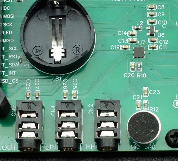

I’m working on a Teensy 4.1 audio project using the Teensy Audio Shield Rev D (SGTL5000) and a CD6283 IC amplifier connected to my speaker. I’m trying to implement real-time audio loopback, where the microphone and speaker are connected to the same codec. The goal is to feed live audio into the microphone and get clear audio output from the speaker, but I’m consistently getting noisy output from the speaker.
Hardware Details:
  • Microcontroller: Teensy 4.1
  • Audio Shield: SGTL5000-based Teensy Audio Shield Rev D
  • Amplifier: CD6283 IC, single-channel (left channel only connected)
  • Speaker: (Add details, e.g., 8 Ω, 6 W, etc.)
Connections:
  • Teensy 4.1 and Audio Shield:Standard I²S and I²C connections
    • LRCLK: Pin 20
    • BCLK: Pin 21
    • SCL: Pin 19
    • SDA: Pin 18
    • DIN: Pin 7
    • DOUT: Pin 8
    • MCLK: Pin 23
  • CD6283 IC Amplifier:
    • Input signal: From the LINE OUT pad of the codec’s left channel (L pin) on the Teensy Audio Shield, with the L pin connected to pin 7 of the amplifier and the GND pin connected to the amplifier’s ground.
    • Input ground: GND of Audio Shield
    • Power: Regulated 12 V from external power supply
    • Speaker: Connected to the CD6283 IC output pins
I tested the Teensy 4.1 with the SparkFun WM8960 audio codec using the same speaker, and it worked fine — I got clear output. However, with the SGTL5000 Audio Shield, I only get digital/hiss/whistle noise.
How can I solve this problem and get clean Audio output?

Now the codec is powered only by the Teensy, and the Teensy is getting power from the USB cable through my PC. Both are connected with jumper wires. When I connect the ground pin (the one marked in red), I don’t get continuity on all the pins marked in yellow. I don’t understand why.
Other than these two pins, I am getting continuity on all the others.
The problem is that sometimes I get a clear output, but after reconnecting, I get the same noisy output again. I’m struggling to get a consistently clean output every time.
Did you make sure to prevent audio feedback? If you use a mic as input and amplified audio as output via speaker, you will get audio feedback depending on the distance between microphone and speaker.
Could be the wiring.
Can you try the board plugged directly ontop the Teensy instead of using jumper wires?
Normally, when the AudioBoard is plugged directly, the path between the red and yellow GND points is shorted within the Teensy. Looking at the traces the Volume pot GND is routed to the top G pin (near 5V), these two will beep when testing continuity. The main GND is the Red one it it should be used when connecting the GND with a wire.
If you intend to use a Volume pot either connect the yellow G to the corresponding pin on the Teensy or just short the yellow GND with the red one on the Audio Board.
I'd suggest checking the returns of all the SGTL5000_1 configuration calls to see if any of it fails. Misconfigured codec can produce a noisy output. The fact that sometimes it works fine, yet more often after reconnecting doesn't suggests it might be something with startup/configuration.

I meant how is everything powered, including amp, and in particular about grounding - a ground loop is often the cause of noise in audio. A diagram showing all the connections between units would provide this info.

Yes, I am doing this now (the board is plugged directly on top of the Teensy instead of using jumper wires). Now I’m getting a clean output.
Thank you everyone for your replies.
