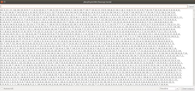

I'm trying to use a random number generator for an audio sequencer using the latest Entropy library and a Teensy 4.0. Everything compiles and appears to work, but simply using Entropy.random(0,15); for a 16-step sequence appears to repeat every 64 numbers. Does this library use a seed function? How should this library be used to improve the randomness, assuming I'm looking for uniform distribution? Also, it looks like there's a normal distribution method Entropy.rnorm(mean, stdv) in there as well, which could be fun to use! But I can't seem to find the documentation for the latest library. Does anyone have some links that could help educate me on the use of the newest Entropy library for a T4.x or at least show me where to find the header file (I'm using PlatformIO)? I read something about a hardware true random number generator which I would love to play around with! Thanks for any tips!
I tried to reproduce this problem with the following code.

Here's the result I see in the serial monitor.
Every line of 64 numbers looks very different to me. It also generates very different data each time I run it.
Entropy uses the hardware random number generator, so you are supposed to get truly random numbers.
Any chance you forgot to use Entropy.Initialize(); in your setup() function?
If it still won't work, please try running that tiny test program with Arduino. If it works in Arduino but not in PlatformIO, maybe report the issue to PlatformIO.
