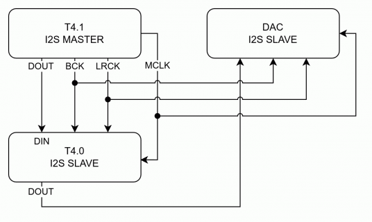

Do you really need two I2S busses for the T4.0? The master (T4.1) provides all I2S clocks, both T4.0 and the DAC could be I2S Slaves with T4.0 put in series in the data line, something like this:

Thanks for the tip. I'll test it. But.. Which pin on the PCM5102 is MCLK :unsure:
The Teensy 4.0 is an FX sound module controlled by the Teensy 4.1. The Teensy 4.1 is an 8-voice synthesizer and sampler with 3 oscillators per voice, digital filters, and a touchscreen. To offload the Teensy 4.1 MCU, the Teensy 4.0 provides reverb, chorus, delay, and other sound effects (see Link).

I2S audio connection: Teensy4.1 (Synth) >>> Teensy4.0 (Fx) >>> DAC (PCM5102)

The Teensy4.0 slave doesn't have an MCLK input :unsure:
I wired it without MCLK and it works. But there are still I2C transmission errors. I've ordered a new Teensy4.0. It'll arrive tomorrow, and I'll test it again then.

    Serial.print(" ");
    digitalWrite(led, HIGH);       // briefly flash the LED
  digitalWrite(led, LOW);
  Serial.begin(9600);             // start serial for output
  Wire1.begin(40);                // join i2c bus with address #40
  Wire1.onReceive(receiveEvent);  // register event
  AudioMemory(64);
  pinMode(led, OUTPUT);
  Serial.println("I2C Slave Receiver with Audio Library Running");
  delay(10);
