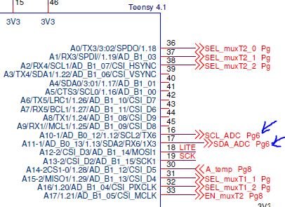

It seems TEENSY41_NE has problem with i2c (wire2). We tried at least two TEENSY41_NE boards and they both show the i2c problem (no messages received from the slave). Exact same code works fine with TEENSY41.
Teensy is used to talk to an external ADC on wire2. We do have 2.2k pull ups on SCL and SDA. We replaced TEENSY41_NE with TEENSY41 on the board and used the same firmware and it works fine.
It would be great if you could confirm the problem. We purchased bunch of TEENSY41_NE and wondering, to replace them, if we have to purchase TEENSY41 separately.

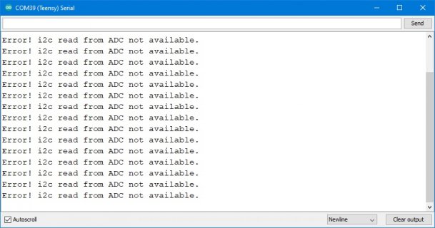

Can you give me a small but complete program to copy into Arduino and run here on a TEENSY41_NE to check?

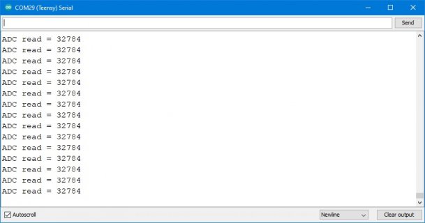

Here it is. I downloaded this exact program in to two different boards one with TEENSY_41 and other with TEENSY41_NE. TEENSY41 prints some ADC reading and does not print the error message. TEENSY41_NE prints only error message.
FYI, the external ADC and the wire2 library information is in there.

That is NOT using the wire library supplied by PJRC in Teensyduino.
Could you try with the Wire.h library rather than the i2c_driver.h and i2c_driver_wire.h drivers.
I think the wire library supplied by PJRC in Teensyduino does not support wire2. At least thats what my understanding is from the table in Hardware requirements section at https://www.pjrc.com/teensy/td_libs_Wire.html. SCL2 and SDA2 were not mentioned.
Anyway, I followed the recommendation in the same page at the top and used library from Richard Gemmell.
Yes it does.
I just replaced i2c libraries you were using with Wire.h and the rest compiled just fine.
EDIT:
If you are using that external (to PJRC) library then perhaps it is a question for him.
The Wire.h library definitely does support Wire2 on Teensy 4.1 (pins 24 & 25). The old web page needs to be updated.
To confirm Wire2 really does work on Teensy 4.1, I connected a SSD1306 OLED display to pins 24 & 25 on Teensy 4.1 and ran the Adafruit_SSD1306 library "ssd1306_128x64_i2c" example. I edited the code to "Wire2" and address "0x3C". The exact code I ran is copied below.
Here it is running on my workbench.
This particular Teensy 4.1 (and all the others on my workbench) have the ethernet chip. If you're sure the lack of ethernet chip somehow affects Wire2, I could grab a TEENSY41_NE and repeat this test. Or anyone with one of these really common little displays could do it too.

I just tested with standard i2c library and its the same problem. TEENSY41_NE does not work and TEENSY41 works fine with same code.
Here is the code. I made change to look for any byte available from Wire2 instead of exact two bytes to see if any/some data is coming on Wire2.

Console output with TEENSY41_NE:
Console output with TEENSY41:

Through USB.

Our first board, Board #1 has TEENSY41 and it worked fine with no problem. We finished our development and built Board #2 with TEENSY41_NE. We faced this problem with Board #2. We then replaced TEENSY41_NE with TEENSY41 on Board #2 and it worked fine with no problem (and with same program before and after replacing Teensy). We also built Board #3 with TEENSY41_NE and it has the same problem. We haven't replaced Teensy on Board #3 because we don't have TEENSY41 on hand.
SCL and SDA from micro. Please ignore the pinout number shown. Our layout engineer used his own numbering. But, they are SCL2 and SDA2.
ADC pull-ups:
