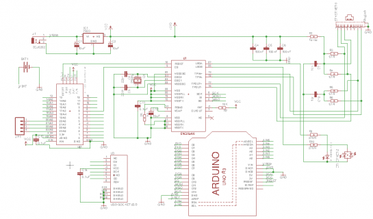

This is a Teensy 3.0 to Arduino (Uno R3 style) footprint. It includes an ENC28J60 ethernet chip, and a MicroSD Card slot. Those are both 3.3v devices, so they're well suited to the Teensy 3.0. The Teensy 3 also has plenty of SRAM, which is handy with the ENC28J60 since the TCP stack is software based, so it takes up precious ram.
I created a Teensy 3.0 eagle library, my first attempt at making a library. It seemed easy enough, I'm pretty sure I got it right. I used the Adafruit eagle library for the Arduino footprint, as well as a couple other components. I referenced the Nanode 5 schematic to wire the ENC28J60 and get the capacitor placement right. I think I got it.
I'm going to get a couple of these made at OSHPark to see if it works, I honestly won't be surprised if I got something wrong, but I sure tried to double check everything. If they pass, I'll release the board designs for all to produce at will. If someone wants to review my schematic/board layout before I submit this to OSHPark (probably in the next day or two), I'd certainly welcome it.

![teensydapter1.png teensydapter1.png](https://forum.pjrc.com/data/attachments/0/48-2703ebcb8575e3232c46023bff147403.jpg)
That's the schematic

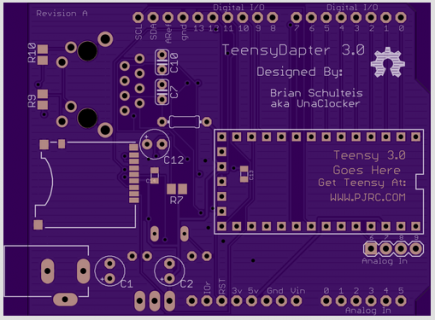

![teensydapter2.png teensydapter2.png](https://forum.pjrc.com/data/attachments/0/49-3264de24aa91dcca9c96abc0d93869af.jpg)
That's the board layout, in Eagle.

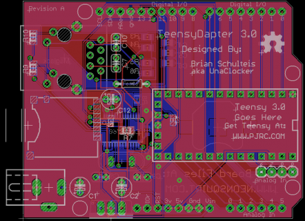

![teensydapter3.png teensydapter3.png](https://forum.pjrc.com/data/attachments/0/50-66a3e2a01c38ab0d462fc8a0ec580aa6.jpg)
This is the top, rendered at OSHPark

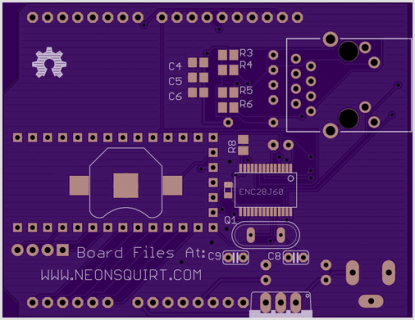

![teensydapter4.png teensydapter4.png](https://forum.pjrc.com/data/attachments/0/51-1112f581dd48b69f4ae336fa4e6dcb91.jpg)
This is the bottom, rendered at OSHPark
