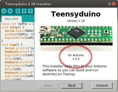

I have several Yun (Yún)'s and need Arduino IDE 1.5.4 or 1.5.5. Paul has said that when I open up his Teensyduino, Version 1.18, and begin installing, it will allow "next" button when it points to a directory where "where you extracted the Arduino Software".
He doesn't say where that typically is and he doesn't say whether I need an earlier version of the IDE or if 1.5.5 will work.
So... If I download raw stuff to /Downloads and unzip there (to a new directory /Downloads/Arduino), then run the installer there, or drag to the applications folder, which of those does he mean?
And what is the "acceptable" IDE version that 1.18 is compatible with???

Teensyduino is not (yet) compatible with Arduino 1.5.5. You'll need to install Arduino 1.0.5.

And, yes, you could just download the latest Release of Teesnyduino, which is an installer (dog file) and run it. When it asks you to point to the Arduino folder, you browse to the one in your Downloads folder and then The teesnyduino installer will start copying files into that.
He doesn't say ..... whether I need an earlier version of the IDE or if 1.5.5 will work.
Please direct your attention to the portion of the installer screen with in the red circle.
(click for full size)

It's all working!
