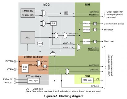

I have re-read your post on clock speeds several times and I think my confusion has to do with the difference between clock speed and the speed of peripherals that are 1/2n multiples. Does the 2 MHz capability only refer to the ability to scale the 48 MHz clock speed down to 2 MHz to run the CAN bus or I2S or whatever? Is that what you mean by peripherals? Or can we somehow run the Teensy clock at 2 MHz? As I am sure you know, clock speed is important for low power applications where the current goes as something like 200 microAmp per MHz. So a 2 MHz clock speed capability for those applications that could afford the speed slowdown would save significant power. Sorry for the lame questions but I really would like to understand this better.
Yes, that's exactly what it does!
Set Tools > CPU Speed to 2 MHz and your Teensy 3.1 will run at only 2 MHz speed.
Really, it's that easy. You choose the speed in that menu and it changes to that speed when your uploaded code runs. It's kinda like magic.
That's why so much work went into version 1.19 to make these extra slow speeds available.
Whatever you select in the CPU Speed menu causes a name to be #defined in the code. Use File > Preferences to show verbose info while compiling to make the exact compiler commands appear when you upload. The code uses that info to configure the hardware.
To understand the hardware, you should look at chapter 5 of the reference manual. On page 156, you'll see this diagram:
(click for full size)
This circuitry lets the chip run from a wide variety of speeds. The system osc on Teensy is always 16 MHz, but the PLL can multiply the frequency, and those OUTDIV circuits can divide it. There are MANY different clocks inside this chip, as you can see in the huge list of section 5.4, but the 3 main ones from from those 3 OUTDIV circuits. Section 5.5 explains some of the requirements of how those 3 clocks must be related to each other. Section 5.7 explains which things in the chip run from which clocks. You'll see almost everything runs from either the system clock or bus (peripheral) clock.
Another key piece of information is this list of clocks:
https://github.com/PaulStoffregen/cores/blob/master/teensy3/kinetis.h#L176
These are the actual clock speeds for all 3, for each of the options you can set in Tools > CPU Speed. This list is merely for documentation, so other code can know which speed is in use. The actual code which configures the hardware is here:
https://github.com/PaulStoffregen/cores/blob/master/teensy3/mk20dx128.c#L414
You can see there are many #ifdef checks, because the hardware is configured differently depending on whether the PLL is needed to increase the frequency, and of course the OUTDIV settings are different for each speed. The exact functionality of all those registers is documented in the reference manual. That PDF is huge, but you can use text search to find those names within the document to learn how each register works.
If you want to understand how it really works, rather than just take my word for the fact that menu really does control the speed, you're going to need to really read that reference manual documentation and the source code. I've written all I can here to point to you to the places to look.
Thanks for the patient explanation Paul, you've made it easy for me to learn what I want to know.
I'll study the reference manual so I can understand what you've done in the source code.
Next time I'll have a more intelligent question for you!
