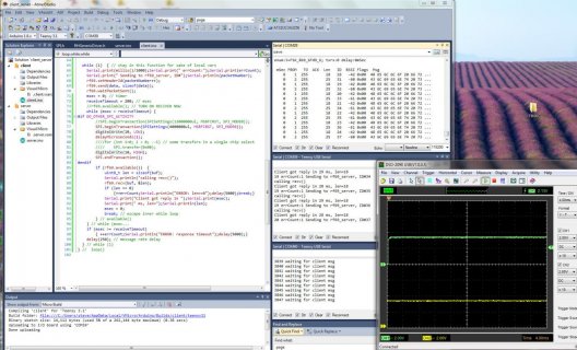

Paul and others re the SPI Transactions in RC2...
RF69 radio issue: SPI Clocks (and/or other related) sent while radio has interrupt request true for a long time due to other use of SPI port...
Using two T3.1's
I got the same code Paul was using running and did reproduce the symptoms.
Next, I decided to simplify the test and observe effect.
I reorganized the looping of the code and put in timers that detected things that might hang, such as transmit complete, etc.
I gave the client and server a "from" address and a packet sequence number. Server=1, Client=2. These both show in my off-air sniffer which I use to see transmitted packets by sequence number and source address, e.g, did it get sent?
(this sniffer is just an RFM69 module with my sniffer code and display on serial).
I changed the modulation mode on the radios to about 9Kbps using a profile that I have found to be among the best of the 20 available. We know there are serious problems with these 20 and we're working on it.
This modulation mode, using this test, and ideal signal strengths, still showed about 3% packet error rate. I put printouts on each end to tally these errors and delay 5 seconds before resuming.
With this, we can know to ignore these errors for the testing goal we have here.
I can run this modified code and see no problems other than the packet error rate for quite some time, with the code to call SPI.beginTransaction() and competing SPI transfers disabled.
The 'scope shows the interrupts from the radio are as expected.
Then I recompile and run with the SPI.beginTransaction(), pin 10 chip select, BUT NO spi clocking transfers. Just the chip select on/off.
After running normally about 15 seconds, the messages stop being transmitted. The 'scope shows that the radio's interrupt request came on and stays on forever.
This doesn't happen unless the transaction manager API call is made.
Looking at my 'scope, I see that the interrupt from the radio is goes true. But the ISR isn't running because there are no radio chip selects. This suggests that somehow the external interrupt enable got left in the false state.
So then I commented out the digitalWrite(10,LOW) and its mate, and ran program. A delayMicroseconds() in lieu of SPI.transfer() calls.
I haven't gotten it to fail. This is without sending an SPI clocks in the test.
Speculation: The new SPI transactions code is is not handling an esoteric of the SPI chip properly. On the AVR, there's the gotcha that if pin 10 (SS) is ever made to be be an input while the SPI chip is enabled, and there is a LOW on that pin, then the SPI chip automatically changes to the SPI slave mode. This may be n/a to the problem, or n/a to the K20.
I have included some code grabs and screen grab. I can make a screen video, maybe narrated, and post that somewhere too.
Also, would it be moot or useful to try this same code with a pair of mega328P boards and the same RFM69 radios and SPI transaction manager code?
Steve
