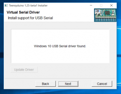

If you run this on Windows 10, please let me know if it detects the Windows 10 built-in serial driver.
Right after the intro, you're supposed to see this:
That's what I saw.

This will leave the prior installed driver - any benefit to removing it?
I have connected both a T_31 and an LC: compiled & uploaded with Win 10 fine to both using button and TYQT
Probably doesn't matter, but of course you can remove the Teensy INF.

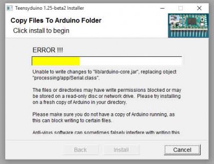

I've changed the links to 1.25-beta2, which updates the installers with support for Arduino 1.6.5-r5.
Support for the buggy "r4" version was dropped. If you downloaded 1.6.5-r4 from Arduino's website, I recommend deleting it.
I just tried installing the second version onto a new install or 1.6.5-r5 (windows 10 64 bit), in default windows location. The Arduino installer replaced ...r2, by uninstalling it and then installing the r5... I then ran the Teensyduino installer with Administrative ...
Received this error:
Kurt
Quick update: I redid this again. This time I went into Windows settings and first had it remove Arduino install. Then I reran the Arduino installer, and then reran the Teensyduino installer and this time it worked?
KurtE - Settings or Task Manager and killed a process? I was about to suggest the installer may be active holding the file even with the IDE closed.
KurtE - why are you using their installer? I gave up on that for the ZIP extract that works without other side effects - trusting their installer seems to have more issues that bugged me before. Their registry attachments and other 'setup' side effects caused grief with multiple active installs and other - the zip extract allows good function across multiple active IDE installs.
Their installer should have already exited. At least it no longer showed up in the taskbar.
Actually I do both ways. That is often I like the main one I am using to be setup the default way... Then if I am testing out something new I use the Zip method...
Why I use their installer, is well that is what the 99% of users probably do, so would be good to test out that approach... Personally I am hoping to be rid of having many different installs. Earlier I had the Arduino 1.0.6 as that was the last thing Trossen (Arbotix) was setup for. Also had 1.5.x and now 1.6.x, plus Intel Edison install. Not to mention the other installs for the Pic32 boards that was playing with...
A process can get orphaned - even MSFT Outlook or IE - waiting for an event on a background task it seems even when the app is no longer a program, not surprising they might have spawned something that they didn't tend to.
I've seen nothing but trouble myself - or in threads here - from their installer, so I banished it and recommend the same as it seemed to be the generally repeated jist I got.
They do registry keys that I saw affect IDE behavior in non-apparent ways and that may work on single installs - but was a recurring trouble with moving 1.6.x beta swarm.
