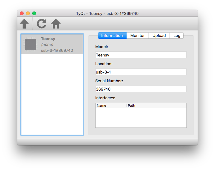

Mac won't recognise teensy
Good evening, I have the same problem that Massel has been reporting. The loader won't even recognise that there's a teensy 3.1 plugged in.
I followed the steps in Paul's response (unplug teensy, start teensy loader 1.26-beta1, turn off automatic mode, plug in teensy while pressing button). Nothing happened, the loader just kept saying "Press button on Teensy to manually enter Program mode". Any attempts at uploading sketches failed. I tried this with the IDE 1.0.6 and 1.6.3, and with a variety of teensyduino/teensy loader versions too. Still no success.
I know it's not the teensy that is dead, it still runs a sketch I uploaded some time ago with no problems.
I'd be extremely grateful to hear about anything else I can try, as the project that I use the teensy for is rather important.
My current setup is: Macbook pro mid-2012 15" (9.1) with OSX 10.11, Arduino IDE 1.0.6 and 1.6.3, both with the teensy loader 1.26-beta1.

Neither of these two worked. It still says the following in the Arduino "IDE"'s console:
Teensy did not respond to a USB-based request to automatically reboot.
Perhaps try a number of different USB cables. Some USB cables, specifically the ones that come with chargers don't have the wires for data and only contain the wires for the 5V.
This has deceived many new users.
@balducien - per @headroom and this thread Not-able-to-upload-sketch-to-Teensy
A bad cable was the problem there. If that doesn't work with a known good cable - moved to other ports - follow that thread to post #6 which is version of Paul's steps - plugging in with button pressed - but patiently pausing before releasing - has helped on Windows. Do you have a second Teensy by any chance you can plug in?
Also you might try TYQT as it may give GUI feedback when a device is detected - though usually only in USB mode except when it is programming it.

First things first, something very suspicious is that the voltage between the GND and Vin pins is only 1.2V, and from GND to 3.3V it's only 0.95 V! (If my multimeter is to be trusted, it's a new one and I haven't tested it a lot. It does show the correct voltages on an ATX PSU though) There doesn't seem to be a significant current being drawn, the teensy stays at ambient temperature. This is the case with two different computers, so I doubt that the USB output is faulty.
I did previously try two different cables, both of which can transfer data from and to an android phone, without success.
TyQt does indeed show a teensy (see screenshot below), however:
- The options in the "upload" tab are greyed out.
- It only shows the teensy for about ten seconds after plugging it in, and only if the teensy has been powered on by something other than USB right before that (if I plug the teensy in several times in a row, it only shows up the first time). Strangely enough it also doesn't show anything if I press the button on the teensy while plugging in.
- Even if I do everything "correctly", it sometimes shows up and sometimes doesn't.
Even if I try to upload a sketch while the teensy is still visible in TyQt, it doesn't respond to the IDE's reboot request.
The voltage is an interesting indication. Was anything ever soldered to it? Has it ever been programmed or running the factory blink? Is it blinking?
TYQT can only see it in USB mode, or when in bootloader mode and will still reset it then when online. The factory blink doesn't have USB and it will go missing from TYQT.
If you press the button on a healthy Teensy it will go to Bootloader and be visible to TYQT. TYQT will then list it and it can be reset with the circular arrow ICON.
That's definitely a hardware failure! The PTC "fuse" is probably getting really hot. (be careful it you try touching it....)
If other stuff is connected to Teensy, disconnect everything you can. Hopefully you'll see the voltage return to normal.
Well shit... The fuse is indeed getting really hot (I'm assuming it's the white component between the USB connector and the regulator). There is indeed a lot soldered to it, and it's a huge mess so this is going to take some time :/ If I manage to find the culprit, will I have to replace the teensy or should the current one still work? Or will I only know that once I disconnect everything (or at least the power pins) and try to program the teensy again?
Usually Teensy survives shorted external circuits drawing way too much current, as long as they're only powered by Teensy and not suppling their own power (and there's not something like a switched inductor or coil creating huge voltage spikes). But this certainly isn't good. If this Teensy does survive this ordeal, I'd mark it as suspect/abused and avoid putting it into anything you want to last and be reliable long-term.
I fixed it! Woohoo!!!!
It wasn't my circuit that drew too much current, it was the new ATX PSU that was powering everything. When I applied power to the teensy via USB, my circuit was still connected to the PSU (may not have been my greatest idea), which snatched itself a few 100 mA. Luckily all the electronics are powered by slip rings, so I can just put a sheet of paper in between the contacts, and my laptop can communicate with the teensy again.
Thanks a lot for pointing me in the right direction, this is not the first time. Have a nice day!
