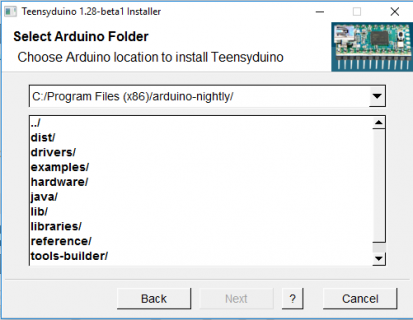

Hi Paul,
I tried to install Teensyduino 1.28-beta1 for Arduino 1.6.8 in W10 but the installer doesn't detect correctly my arduino version .
Teensy.PNG.
Any clure how to fix that?
Thanks
Christian
