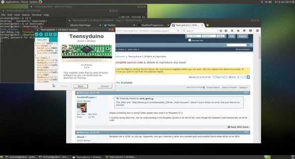

Screenshot at 2016-07-08 10:13:15.jpg
1.29 working fine on 32bit Ubuntu Mate 16.04. I'm quite fine with this. thank you again everyone. appreciated as always.
