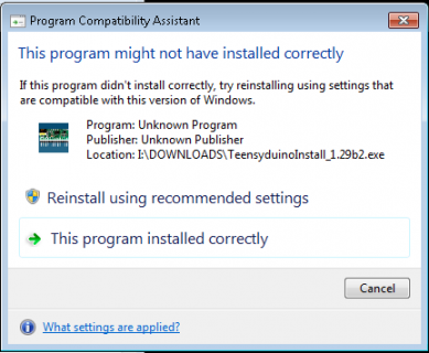

This is OK?
No, it's first time I see this too!
Apart that it install normally and everithing works...
Win7/64
I'm still on IDE 1.6.8 - but just put 1.29B2 on Win 10 and Win 7 and both looked right on the Serial Driver screen: no Win 10, and all good Win 7/64/Ultimate.
On Win 7 I did get this warn after OK:
I got the same of Defragster with all version of Teensyduino I've used in the last 2 years as well but since it's just a warn I always ignored., ant the end it just run fine.
I have the same result with some old driver installer, pre win7.

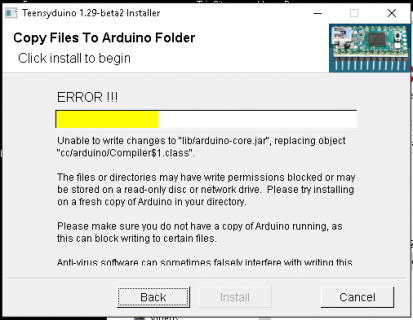

i got this error once
i quit the installer and rightclicked it - run as admin
still the same bug
the arduino-core.jar is NOT read only
but the lib folder was , i removed the read only on the lib folder and subfiles and re tried
same error
when up a folder in the tree , removed the readonly
tried again , same error
and removed the read only on all the folders in the tree
E:\Program Files (x86)\Arduino\lib
same error
i m on windows 10 pro N
Confirm the IDE is closed and that no JAVA processes are active in TaskMan ( perhaps reboot ) - someone reported and I reproduced a similar effect when the IDE/JAVA was active - perhaps on the 1.29 Beta #1 thread.

I posted about the read-only thing this morning , the IDE was running , i closed , saved everything , restarted and retried
it worked
I m sorry for this noobish error , i know better than that .
Thanks
