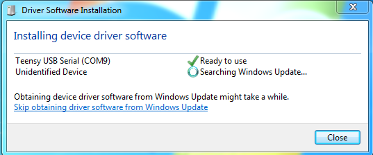

Had a T_3.2 online with the K66 and hit Upload and it picked the T_3.2 as first device and gave appropriate 'conflict' dialog - unplugged T_3.2 and K66 button press was ignored - like it didn't rescan - I had to IDE Upload again to get it seen.
Win_7 machine not happy with K66 staring at this for a couple minutes - then went to error - I suppose this was the HID device that went away before it completed install:
In the end it is working fine - on com port #9 as indicated. No problems uploading.

Opening Teensy Loader...
Unable find Teensy Loader.  Is the Teensy Loader application running?

Error compiling for board Teensy 3.2 / 3.1.
I frequently experience this problem reported for beta 2 on teensy 3.1. It will even report "download complete" when there is no Teensy connected to the computer at all. That message needs to be fixed.
The suggested workaround, Loading the blink sketch, was very hit and mis due to the circular problem of loading it in the first place, but it did help in some cases. For this reason, I request that the next Teensy Hardware version please bring RESET out to a hole, or a button. lsusb showed that the teensy would frequently disappear from the list. Best results were obtained with high quality(short) USB cables and laptop running on AC. Teensy fails to load ~80% when laptop running on battery.
Perhaps when program mode button is pressed, it could save context and disable some of the high current, high resource peripherals, interrupts, and tristate output pins and wait for current to settle down before looking for teensy loader. Likewise, Teensy Loader might wait a bit longer for an overloaded Teensy to respond.
Teensy 3.2, Arduino 1.6.9 (Arduino 2), empty sketch. Verify is OK but download results in 'download complete' from Arduino IDE but
Teensy did not respond to a USB request to automatically reboot
Please press the PROGRAM MODE BUTTON on your Teensy to upload your sketch
No amount of pressing that button/in any order before/during/after the above error results in anything but a repeat of that error message.
Thoughts?
Please note that NO code has changed from the time this project compiled and worked on beta 2, through the 4 compile attempts on beta 3. Yet, identical code resulted in 4 different messages from the IDE.
The next compile attempt resulted in
Teensy Loader error responding to comment
This sketch compiled fine on TD: 1.29-beta2 with everything else the same.
