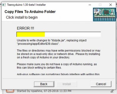

I tried installing on Windows 10, onto Arduino 1.6.10 (installed zip file to c:\Arduino-1.6.10. This was after a fresh power up for the day and I have not run Arduino yet. The only things running Outlook, Firefox, Github for Windows, SublimeText.
I did not run as Administrator. It properly allowed me to select the Arduino folder, the install started, so I went to looking through forums. Went back to the install app, to assume I would have click to finish... But instead had:
Cancelled out of TD, and tried to run as Administrator. Now it does not think my Arduino folder is a valid place to install...
Will now kill that directory and install Arduino again. Luckily still have zip file.
UPDATE: I installed frsh copy of 1.6.10 and ran Teensyduino again and it worked fine. I think there was something screwy with my Arduino 1.6.10. Maybe some of the playing around yesterday with it. So now up and running! :D

Tried to Install on OSX 10.10.5.
Using Arduino Verison 1.6.10.
Teensyduino installed does not recognise the Arduino folder as a valid location for the Install.
(My App in in the Applications Folder with the name Arduino 1.6.10)
Any one else had the same issue?
Infact.... please disregard that previous post.
I re-downloaded the Arduino File and it now installs fine.

KurtE - that error was probably from an orphaned JAVA thread holding the JAR open.
