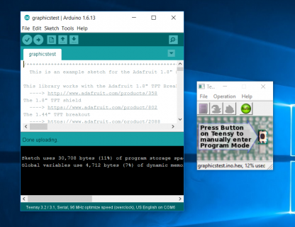

Just installed on Arduino 1.6.13 with Windows 10 64 bit. Arduino installed from ZIP file.
Tried compiling a program (graphic test for ST7735_t3) to download to T3.2...
Opening Teensy Loader...
Sketch uses 33,428 bytes (12%) of program storage space. Maximum is 262,144 bytes.
Global variables use 4,756 bytes (7%) of dynamic memory, leaving 60,780 bytes for local variables. Maximum is 65,536 bytes.
C:\arduino-1.6.13\hardware\teensy/../tools/teensy_post_compile -test -file=graphicstest.ino -path=C:\Users\Kurt\AppData\Local\Temp\arduino_build_356634 -tools=C:\arduino-1.6.13\hardware\teensy/../tools -board=TEENSY31 -reboot
Unable find Teensy Loader.  (r)  Is the Teensy Loader application running?
Is a firewall (eg, ZoneAlarm) blocking localhost communication?
Shows current Comm port 9(Teensy).
Clicking on program button does program the chip.
Tried rebooting to make sure there was not some random app still running. Still fails
I also installed on MAC with Arduino 1.6.12 and it appears to work.
Likewise installed on UP board running Ubuntu 16.04 on Arduino 1.6.13 and it and it appears to work there as well.
So only my main windows machine not working...

@KurtE - Could you give this a try? These 2 utilities go into hardware/tools within Arduino. Does it fix the erroneous "Unable find Teensy Loader" message on your Windows system?
  • sync_test3_windows.zip
Sorry No :eek:
Sketch uses 20,728 bytes (1%) of program storage space. Maximum is 1,048,576 bytes.
Global variables use 3,964 bytes (1%) of dynamic memory, leaving 258,180 bytes for local variables. Maximum is 262,144 bytes.
C:\arduino-1.6.13\hardware\teensy/../tools/teensy_post_compile -test -file=Blink.ino -path=C:\Users\Kurt\AppData\Local\Temp\arduino_build_900934 -tools=C:\arduino-1.6.13\hardware\teensy/../tools -board=TEENSY36 -reboot
I then tried running 1.6.12 with 1.31 and uploaded blink without issue.

@KurtE - Here's yet another attempt. I know this is probably getting tedious, but it's a huge help if you can give this a try. I *really* want to get this sync issue fixed for the 1.32 release.
  • sync_test4_windows.zip
Sorry to say still same results. - As a sanity test, should I try installing 1.31 on this build and see if it acts differently?
Yes, would be good to compare with 1.31.
I've been unable to reproduce the problem on my windows test machine, so there's not much I can other than guessing. :(

Paul, not sure what to say?
I tried redownloading a fresh copy of Arduino, just in case.
I then downloaded TD 1.31, but of course not supported.
So downloaded TD 1.32b1 and installed and the upload worked fine.
I then downloaded the 1.32b2 and reproduced not able to sync..
Tried test 4 above again and still:
Running windows 10 Pro
