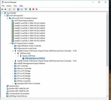

It is sort of strange. I turned on verbose and the first time I ran it actually programmed properly, turned it off, it failed, turned it back on it succeeded first time, but then failed the next 3 times, then 1 success and then several more failures. Maybe 1 out 10 worked...
Does not give much more information
"C:\arduino-1.6.13\hardware\teensy/../tools/arm/bin/arm-none-eabi-ar" rcs "C:\Users\Kurt\AppData\Local\Temp\arduino_build_637172/core/core.a" "C:\Users\Kurt\AppData\Local\Temp\arduino_build_637172\core\usb_flightsim.cpp.o"
"C:\arduino-1.6.13\hardware\teensy/../tools/arm/bin/arm-none-eabi-ar" rcs "C:\Users\Kurt\AppData\Local\Temp\arduino_build_637172/core/core.a" "C:\Users\Kurt\AppData\Local\Temp\arduino_build_637172\core\usb_inst.cpp.o"
"C:\arduino-1.6.13\hardware\teensy/../tools/arm/bin/arm-none-eabi-ar" rcs "C:\Users\Kurt\AppData\Local\Temp\arduino_build_637172/core/core.a" "C:\Users\Kurt\AppData\Local\Temp\arduino_build_637172\core\yield.cpp.o"
Linking everything together...
"C:\arduino-1.6.13\hardware\teensy/../tools/arm/bin/arm-none-eabi-gcc" -O -Wl,--gc-sections,--relax,--defsym=__rtc_localtime=1481208461 "-TC:\arduino-1.6.13\hardware\teensy\avr\cores\teensy3/mk66fx1m0.ld"  -mthumb -mcpu=cortex-m4 -mfloat-abi=hard -mfpu=fpv4-sp-d16 -fsingle-precision-constant -o "C:\Users\Kurt\AppData\Local\Temp\arduino_build_637172/Blink.ino.elf" "C:\Users\Kurt\AppData\Local\Temp\arduino_build_637172\sketch\Blink.ino.cpp.o" "C:\Users\Kurt\AppData\Local\Temp\arduino_build_637172/core\core.a" "-LC:\Users\Kurt\AppData\Local\Temp\arduino_build_637172" -larm_cortexM4lf_math -lm
"C:\arduino-1.6.13\hardware\teensy/../tools/arm/bin/arm-none-eabi-objcopy" -O ihex -j .eeprom --set-section-flags=.eeprom=alloc,load --no-change-warnings --change-section-lma .eeprom=0 "C:\Users\Kurt\AppData\Local\Temp\arduino_build_637172/Blink.ino.elf" "C:\Users\Kurt\AppData\Local\Temp\arduino_build_637172/Blink.ino.eep"
"C:\arduino-1.6.13\hardware\teensy/../tools/arm/bin/arm-none-eabi-objcopy" -O ihex -R .eeprom "C:\Users\Kurt\AppData\Local\Temp\arduino_build_637172/Blink.ino.elf" "C:\Users\Kurt\AppData\Local\Temp\arduino_build_637172/Blink.ino.hex"
"C:\arduino-1.6.13\hardware\teensy/../tools//teensy_post_compile" "-file=Blink.ino" "-path=C:\Users\Kurt\AppData\Local\Temp\arduino_build_637172" "-tools=C:\arduino-1.6.13\hardware\teensy/../tools/" "-board=TEENSY36"
Sketch uses 20,584 bytes (1%) of program storage space. Maximum is 1,048,576 bytes.
Global variables use 3,964 bytes (1%) of dynamic memory, leaving 258,180 bytes for local variables. Maximum is 262,144 bytes.
C:\arduino-1.6.13\hardware\teensy/../tools/teensy_post_compile -test -file=Blink.ino -path=C:\Users\Kurt\AppData\Local\Temp\arduino_build_637172 -tools=C:\arduino-1.6.13\hardware\teensy/../tools -board=TEENSY36 -reboot
Opening Teensy Loader...
Unable find Teensy Loader.  (r)  Is the Teensy Loader application running?
Is a firewall (eg, ZoneAlarm) blocking localhost communication?

Just started computer up and getting ready to download latest.
But some more info: again windows 10 64 bit. Trying to program blink to teensys that already have been programmed, USB Serial, USB2 directly connected to computer (which of course has it's own HUB).
Above shows the USB connections...
I can try other connections if desired, like USB3 or the 2nd USB2 controller 1C26...
The same connections/setup works with TyQt. Also works fine with Teensyduino 31 and 32b1.
Now to download and see what I get.
