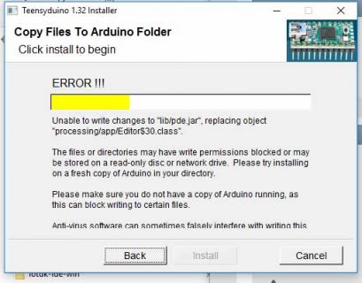

I ran into an issue installing Teensyduino on my Windows 10 64 bit Arduino 1.6.13... I get error messages like:
I tried with the current one 1.33 as well as the current one here and get this error.
I tried rebooting, I deleted the old Arduino and unzipped a new 1.6.13 to c:\ tried running as Admin... Will try to download fresh copies again...
I had that error while installing 1.13b2 but I had forgotten to kill a T3.6 project that I had open in the IDE. Killed it, started again, all OK.

This time I tried it again, with a freshly downloaded Arduino IDE, I just rebooted, then unzipped the Arduino IDE to c:\ and then tried running the Teensyduino, same error...
Maybe should try on another machine... Will try later, now getting ready for company...
Edit: I also tried installing Arduino in my Documents folder and rerun the Teensyduino... Failed there too.
At times like this I wonder if 1.6.13 now is the same 1.6.13 when it was released
Update: I think it is the Virus detector:mad: must have changed. I turned McAfee real time scanning off for 15 minutes and was able to update the two directories that failed earlier :D
