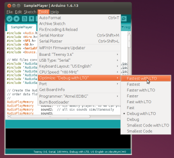

This beta adds a Tools > Optimize menu, so you can easily experiment with 10 different optimization settings.
(click for full size)
LTO is Link Time Optimization. It can really reduce the size and increase the speed of many programs. But it might come with compatibility issues.
Fastest, Faster and Fast are optimization flags -O3, -O2 and -O. Debug is -Og, and Smallest is -Os plus use of the nano C library.
Please give these various settings a try. We probably have a couple months before Arduino releases a new version. If this toolchain update or LTO breaks too many programs & libraries, I can always revert to the 4.8 toolchain. But hopefully we can play with this quite a bit in the coming weeks and build enough confidence to use it in a non-beta release.

That added 'optimize' Menu does look nice.

i tested 1.6.12 with 1.34beta1 on mac os,
coremark:
previously T3.2@96mhz -O2 189.4 iterations/sec | with LTO fastest 207.29
previously T3.6@180mhz -O2 384.0 | with LTO fastest 447.7
... so many optimization choices ...
T3.6@180mhz coremark
        fastest LTO 447.676389
        fastest     463.692033
        faster LTO  437.121360
        faster      434.528617
        fast  LTO   333.619557
        fast        333.032915
        small LTO   323.248789  no float printf
        small       320.692182
is compiler doing hardware floating point? my linpack benchmark with LTO fastest is giving < 1 megaflop, should be 30 megaflops
