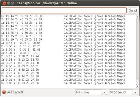

Possible I2C issue. I installed IDE 1.8.2 with the teensy 1.36 beta 4 teensyduino. I have a Adafruit BNO055 attached to I2C. It seems like every time I upload a sketch to a Teensy 3.5 it does not see the device anymore. If I cycle the power it will see the device but the values that are being read are incorrect for yaw, pitch and roll. The come out on the order of 0.06 or 1 deg for each axis and do not change. If I revert back to 1.8.1 it works fine no problem.
@mjs513 :: This may be a side effect of USB serial coming online faster and not allowing the I2C device time to reset/restart. The new code can have USB online some 300-350 ms faster. If the following shows that you would need to add a sufficient wait to make up for that and allow the i2c device to be ready.

Based on the comparison - the fix may be "delay(350)" or "while( millis()<900 );" - whatever it takes to make up the time difference before _i2c_.begin().
Can you tell me more about how you're testing? Are you running one of Adafruit's examples, or your own program?

Paul. I using a modified example in my robotics project. Let me give @defragster solution a try and see what happens. If I still have problems I can send you the part of the code that I use to initialize the BNO055. Or I can post the whole thing to GITHUB and let you take a look. The BNO055 is in its own tab so it would be easy. let me know. It is the only thing on the I2C bus but I am using some threads, and attaching all kinds of other stuff to the Teensy 3.5.

With 1.8.1: millis0 = 5404, millis = 5404. Almost no delay. (had to put a delay of 5000 in so give me time to open monitor
With 1.8.2: millis0 = 404, millis = 1405. So this is some delay. In this case I did not have to put in the delay.

@defroster. In 1.8.1 I am using TeensyDuino 1.35. In 1.8.2 I am using TeensyDuino 1.36 beta 4. Sorry about the timing I was misinterpreted your suggestion. Think I am working too many projects one time. I did find the issue related to the data from the BNO. Its all thread related. Readings for the BNO work fine in the non-threaded application. Think I may have another problem that I am going to check on tomorrow.
@defragster. I added the delay just like you recommended and that seemed to resolve the startup issue. I was also able to fix the my data issue by adjusting the thread coding. Thanks very much. Its nice not to have cycle the power anymore.
