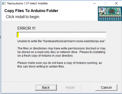

Had to CLOSE MALWAREBYTES to get install to run
w/1.37b1 Now able to upload under Win 10 Creator's Update winver=1703 and IDE 1.81
Used MSFT Win10 ISO DVD to get Creator's Update on my Win 10 Pro box - TyCommander okay - but Teensy.exe only did any upload with button press - even when IDE 'port' saw "COM7 (Teensy)".
So decided to put the 1.37b1 on this machine with IDE 1.81 and got this ERROR stoppage:
This persisted with the following::
Unblocked the "TeensyduinoInstall_1.37b1.exe", and ran as ADMIN.
Closed IDE and SubLimeText with Stino - already UN-Integrated TyCommander and it was closed.
Nothing relevant in TaskMan
FOUND IT - Had to CLOSE MALWAREBYTES.
This is the first new TeensyInstall since Malwarebytes went hard core in upgrade from 2.x to 3.x and added anti ransom ware and other new stuff.
<edit>: BTW
> Malwarebytes slows compiles horribly unless RansomWare is turned off.
> If Win 10 machine is SLOW and Net freaky - the Creators Update may be failing - my four are and some customer machines. I make a disk from here - do 'Upgrade from within Windows': Create Windows 10 installation media
I have to turn off MCAfee real time scanning when I install Teensyduino... Have had to do this for sometime now....
