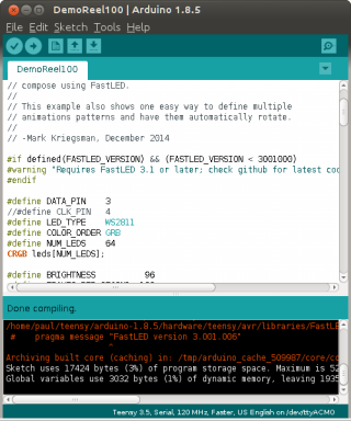

Know 1.40 is out but I just downloaded the lastest fastLED library and it threw an error for the T3.5 (see below).
Multiple libraries were found for "FastLED.h"
Used: C:\Users\CyberPalin\Documents\Arduino\libraries\FastLED
Not used: C:\Local Programs\arduino-1.8.5\hardware\teensy\avr\libraries\FastLED
Error compiling for board Teensy 3.5.
#include <FastLED.h>
Thanks
Mike
