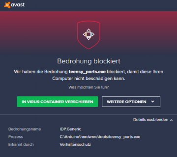

A false positive with Avast Antivirus (teensy_ports.exe):

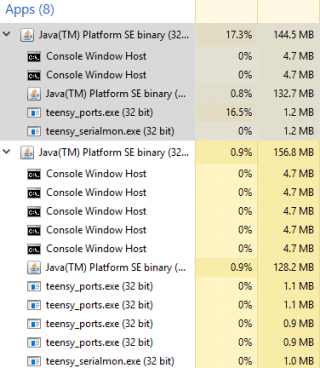

Paul: I just had IDE being sluggish ( two open ) - found 18 [Eighteen ] copies of teensy_ports.exe <edited to be clear not just one was sluggish>
Multiple Teensy_ports.exe do not show in TaskMan until AFTER the IDE is closed.

IDE was sluggish and closed - now I see 21 copies of teensy_ports.exe.
No Tools/Ports T_sermon - clicks on the IDE Sermon icon did nothing ( maybe that is the spare copies of teensy_ports )
not :: Seems to be working after cleanup again with a few minute wait
>> REBOOT required. Above behavior is stuck from something ...
<edit>: Rebooted and Brought up T_3.1 then the T-3.6 as used before all is normal now. This was not opening T_sermon during compile. Only thing I can think of is perhaps in opening two IDE's and loading sketch and changing the device - I may have not changed the Teensy Port id? Thus having two IDE's looking for the same port?

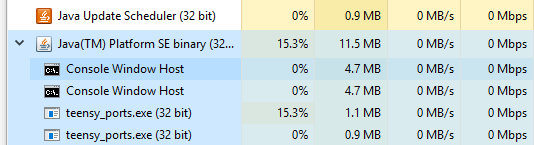

TASKMAN - IDE's and TLoader closed:
> (4) copies of teensy_ports.exe
> Java Platform as shown in image

Until the IDE JAVA is closed TaskMan shows the teensy_ports and teensy_serialmon.exe under the IDE's JAVA App entries - when the IDE exits they are Orphaned and then appear under 'Background processes'.

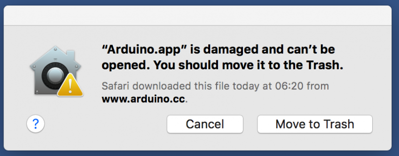

Hi There,
A bit of a problem here with the teensyduino 64 bit mac install and a newly installed and never executed Arduino 1.8.5, High Sierra doesn't like the arduino.app after teensyduino has patched it, see attachment.
Installing 1.85, running it once then updating with the teensyduino 64 bit dmg works fine.
I'm guessing this is some HS security issue with the app being modified before being executed.
Cheers
Andy
That's definitely a bug. The teensy_ports.exe program is supposed to check if any prior instance is running.
It's supposed to do this check by looking with WIN32 GetTcpTable() to check if any other copy is listening on 127.0.0.1 ports 28542, 4985, or 18925. If it can't load the GetTcpTable() function, it falls back to trying to actually connect to those ports (which is stupid slow on Windows to tell that no program on your own computer is listening... which is why I put the code in to do it with GetTcpTable). There very well may be a bug in that code. :(
I'm going to package up 1.42-beta4 with this stuff as-is. Please keep an eye out of this multiple teensy_ports.exe running. If it's still happening, I'll try building some copies that print a bunch of info about this checking. I'm not so good at reproducing Windows bugs here, so could really use help tracking this one down...
