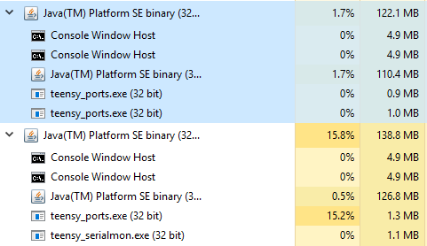

!!!! > 2nd tports !!!! :: TL:verbose >> callback stopped
Test found in IDE #2 :: Generated 4 lines each click 'Tools' - Ports has no 'Teensy' section:

restarted at 9:18 … waited … got twin Tports
This repeated as I did it before:
in TaskMan close of ALL Tports when in this state causes a clean working restart of a SINGLE Tport for both IDE's. The 'callback' persists and both Tsermon's active and I can upload to them in turn.
