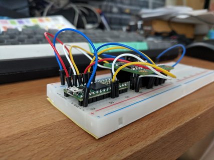

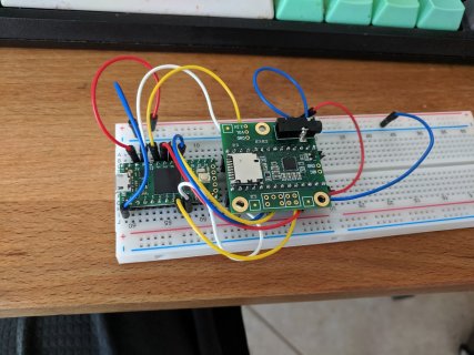

#include <SerialFlash.h>
AudioSynthWaveform waveform1; //xy=294,323
AudioEffectFreeverbStereo freeverbs1; //xy=592,499
AudioOutputI2S i2s1; //xy=756,481
AudioConnection patchCord1(waveform1, freeverbs1);
AudioConnection patchCord2(freeverbs1, 0, i2s1, 0);
AudioConnection patchCord3(freeverbs1, 1, i2s1, 1);
AudioControlSGTL5000 sgtl5000_1; //xy=805,363
int count=1;
int a1history=0;
// this is the offending line, and I'm not sure why it is necessary
// it can be placed anywhere within setup, it doesn't seem to matter
a1history = analogRead(A1);
AudioMemory(10);
sgtl5000_1.enable();
sgtl5000_1.volume(0.3);
Serial.print("Beep #");
Serial.println(count);
Serial.println(AudioProcessorUsageMax());
AudioProcessorUsageMaxReset();
count = count + 1;
waveform1.frequency(440);
waveform1.amplitude(0.9);
wait(250);
waveform1.amplitude(0);
wait(1750);
void wait(unsigned int milliseconds)
delay(milliseconds);
I am using arduino 1.8.10, with the teensyloader 1.48-beta1.
1.48-beta1 is haunted by evil spirits. upgrade to 1.48-beta2 or beta3
