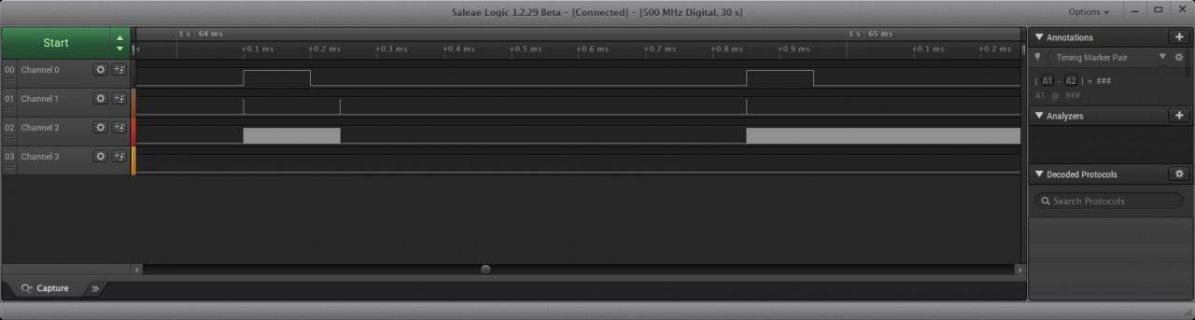

Then hooked up LA to pins 9 (and 11 as they are jumpered to each other and 2 and 3...
If you then look at LA output:
You will see there is just one interrupt on the output and a ton of them on input...
Note: I am getting ton of outputs... With time between 0 micros...

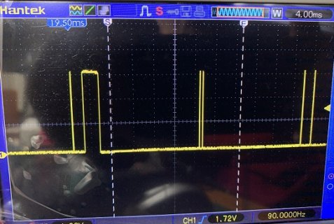

EDIT2: I just put a scope on pin 13 while running the sketch and the signal is affected by the input config/ISR
Without attaching pin 11 (rxpin) the signal looks like the 2 narrow pulses in the middle of the image
@KurtE
Been playing....
FYI - I create the base class and made Input and Output based off of it, and my test sketch is still working...
I am probably done for awhile... Need to go to store...
@KurtE ….
See been busy while I was out --- really simplified the code using that base class. Have to digest it a bit more though.
Just ran a couple of quick tests with the lib in post #72:
1. pin 13 output on T4(A) to pin 11 on T4(B). (A) running single channel out of 600.03. On pin 11 of (B) I am seeing:multi-channel output when it should be only 1 channel showing:
101 :  600.08  176.37  600.08  176.37
102 :  176.37  600.08  176.37
103 :  176.37  600.08  176.37
104 :  176.37  600.08  176.37  600.08
2. pin 13 output on T4(A) to pin 11 on T4(B). (A) running mutli-channel output of 3 frequencies (600.03, 1500.00, 759.24). Catching but acting like it is 3 single frequencies:
0223 :  600.08
10224 :  1412.35
10225 :  759.28
10226 :  600.05
10227 :  759.28
10228 :  1500.05
10229 :  600.08
10230 :  759.28
10231 :  600.08
10232 :  600.08
10233 :  759.28
10234 :  600.08
10235 :  1412.35
3. Multi-pin output on (A). On (A) pin 13 sending single freq of 600.03 and pin 11 sending 634.56; (B) on pin 11 receiving since that is the only working one right now:
Output from pin 13:
24219 :  600.08  176.37  600.08  176.37
24220 :  176.40  600.08  176.37
24221 :  176.37  600.08  176.37
24222 :  176.37  600.08  176.37  600.08
24223 :  600.08  176.37  600.08  176.37
24224 :  176.37  600.08  176.37
Output from pin 11:
23379 :  634.59  141.87  634.59  141.87
23380 :  141.87  634.59  141.89
23381 :  141.87  634.59  141.87
23382 :  141.87  634.59  141.89  634.59
23383 :  634.59  141.87  634.59  141.87
Can still only get input on pin 11. No other pin works
