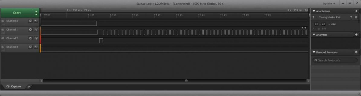

Re: daisy register
I was lucky in my QTIMER proof-of-concepts, i just tried pins 11 and 6 and didn't stumble on a daisy register. However, in the last few days I've been playing with eflexPWM timers to do PPM input and output, and pin 8 did require a SELECT_INPUT daisy register config. (Paul's T4 FrequencyMeasure uses eflexPWM capture on pin 22 and also requires a daisy register.)
@mjs513, the programming gods are smiling on you: :) TMR_CTRL_SCS(14) should be TMR_CTRL_SCS(2) for pin 14 (QT3_2). Conveniently 14 mod 4 = 2
FWIW, i haven't been able to get PPM out to work with long (> 16bit) pulse width using flexPWM timer. I did get PPM in to work with flexPWM timer (capture and overflow interrupts).
https://github.com/manitou48/teensy4/blob/master/ppminf.ino
@manitou - @KurtE
That's what I get for playing with this when I can't sleep at 2 in the morning:) Knew it was channel but still put pin, argh.
Anyway, what to try the input example with different pins outside the lib structure to see if changes would work. Daisy Chain worked for pin 14 but not in the lib. That's one test. The second test I just did was to use pin 13 for input (QT2_0). And unless I forgot to change something doesn't look like pin 13 will work as an input pin unless something else has to change: EDIT: YEP FORGOT the Daisy Chain - once I do that it works as well.

EDIT: Interestingly Pin18 works without setting the daisy chain register - probably because its already 0? Pin 19 works but you need to set the IOMUX register.
EDIT1: pin 6 does work as input, but pins 11, 12 do work as input getting the correct values
RE: FOUND THE HANG FOR PINS OTHER THAN 11
Hangs on this line:
	//set Mux for Tx Pin - all timers on ALT1
	*(portConfigRegister(rxPin)) = 1;
Yes I changed pin variable name. Works if you set it to 0 but that was just curiosity.
Hangs on this line:
maybe try *(portConfigRegister(rxPin)) = 1 | 0x10;
Good morning...
Yep - I have seen it hang at or near there... Sometimes it goes a bit longer... before hang...
bool PulsePositionInput::begin(uint8_t pin)
