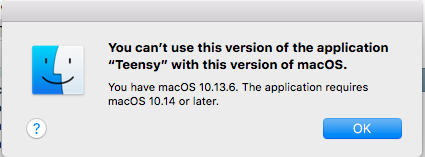

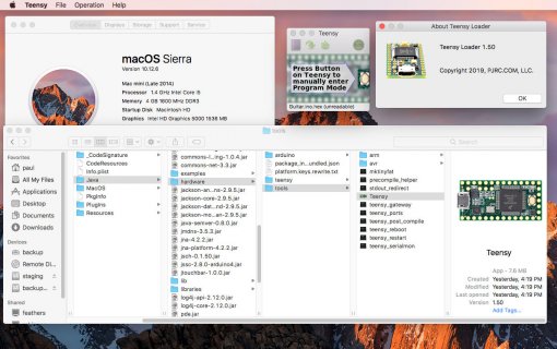

I have no idea why your Mac is saying Teensy Loader requires 10.14. It doesn't (or shouldn't).
I ran it this way just now on 10.12.6. Here's a screenshot.
At least 2 people on Twitter have confirmed it ran on their old Macs with 10.10 Yosemite. One specifically said uploading code to a Teensy 3.2 worked.
https://twitter.com/bikerglen/status/1223766258723639296
https://twitter.com/Dithermaster/status/1223777431099793408
