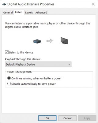

Here is a PMF Player SdFat v2 BETA + DMAMEM Buffer + Audio USB example.
pmf_player_2_minimum.zip has all the files.
Needs SdFat-beta ver "2.0.0"8 (Fix for Teensy 4.1) beta version of SdFat Version 2
ISSUE: Audio library pulls in SD.h library but we need SdFat-beta ver 2.0.0.8 !!!!
Windows 10 C:\Users\---?----\Desktop\arduino-1.8.12 BETA4\hardware\teensy\avr\libraries\Audio
Needs editing in play_sd_raw.h, play_sd_raw.ccp, play_sd_wav.h & play_sd_wav.ccp.
IN *.h ( #include "SD.h" ) TO - > ( #include "SdFat.h" )
IN *.ccp ( wavfile = SD.open(filename); // SD.h } TO - > { wavfile.open(filename); // SdFat.h )
Or use the Audio_fix.zip
How to use this example:
Set Audio USB in Arduino IDE Tools menu - USB Type: "Audio"
Open serial monitor and change to Newline or Carriage return at the bottom, press Send.
Needs micro SD card with PMF files.

Also I had no USB Audio on Windows 10 till I was messing with sound settings and choose listen to this device somewhere in Recording - Properties.

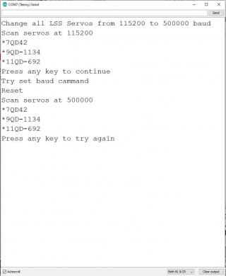

I thought I would mention again with the current Teensy terminal, there is an issue of doing cuts and pasts from the terminal window to other places, often double spaces on the paste. I believe that you are holding onto the \r ....
Here is the output of a program if I do cut and paste:
Change all LSS Servos from 115200 to 500000 baud
Scan servos at 115200
*7QD42
*9QD-1134
*11QD-692
Press any key to continue
Try set baud cammand
Reset
Scan servos at 500000
*7QD42
*9QD-1134
*11QD-692
Press any key to try again
The actual screen looks like:
The actual code:

The spacing issue is from Teensy putting both \r\n on println() and the T_SerMon storing/returning it that way - at least on Windows as Kurt notes.
Using TyCommander as Sermon this does not happen - lines copy and paste on Windows to Notepad or other without 'blank lines' from println(). But when cut and paste from T_SerMon - the \r\n on the output results in blank lines for each println().
It would be nice if someday T_SerMon on Windows didn't do that duplication - until then Serial.print('\n'); works better than Serial.println(); for cut and paste.
