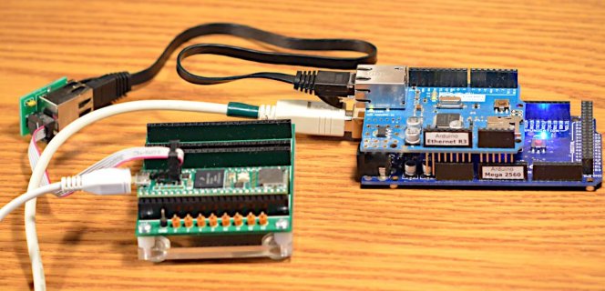

Could you run the second code on a a second T4.1? I only used a Mega2560 as one was available.

My understanding is I'm supposed to run this test using Teensy 4.1 (running the 1st program) connected to an Arduino Mega (running the 2nd program) with Arduino Ethernet Shield. Is that right? Can you tell me exactly which Ethernet Shield you used? Subtle differences exist between the W5100, W5200, W5500 chips used on the many ethernet shields. Did you connect the 2 boards directly with a cable, or were they both plugged into an ethernet switch or hub?
And I know this question may be redundant, but please tell me you actually ran this EXACT code on those 2 boards and saw the problem, right? Many, many times on this forum we've seen a program like this which is adapted from much larger code. Sometimes people do not actually test the reduced code. I'm not trying to say you would do such a thing, only that many times I've put hours of work into running a program like this and ultimately it was unable to reproduce the problem because it lacked some detail from the larger original code.
Please, confirm you actually ran these exact 2 programs, and tell me exactly which non-Teensy shield was used with Arduino Mega.
Hi Paul, yes, these exactly two programs have been used.
The problem is infrequent, and one need patience to see it. Its low frequency explains, why the fault is less frequently seen on applications with low Ethernet traffic.
Confirmed, the Teensy 4.1 stopped printing after about 40 minutes. The Arduino Mega side started printing "connection # ... failed" messages.
Later today I will work on reproducing the error more rapidly....
Sorry for the my silence on these issues recently, but I haven't had time to dedicate towards this. I'm aware of what's happening with the TCP code and why it's seemingly running out of sockets out of nowhere. This was previously reported here: https://github.com/vjmuzik/NativeEthernet/issues/7
The short of it is that when EthernetServer.available finds a client it opens a socket and expects the client to send data first before returning with an active client. From what I've been able to deduce with Wireshark is that FNET is losing that TCP data seemingly at random intervals meaning that EthernetServer.available will never close the socket because it's still expecting data to arrive. Eventually you will run out of sockets, see the link above to easily reproduce this without having to wait 40 minutes.
Unfortunately aside from implementing a blocking timeout on EthernetServer.available to detect the socket that doesn't receive data I haven't been able to pinpoint where exactly in FNET the data is getting lost. This is obviously a quick solution, but it was not one I was particularly happy with, so I never committed it, because it drops the socket altogether and I wanted to find the cause of the missing data.

I've been looking into this NativeEthernet bug. Indeed the crash is happening deep within FNET. It's going to take some serious work to unravel to figure out what the actual cause really is.
Just to be realistic, this is very unlikely to get fixed in 1.54. So many other things are updated & improved, and it's been just over 1 year since 1.53 and Arduino 1.8.15 is now 7 weeks old. We really need to wrap up 1.54 now.
But I definitely will be diving into this problem in the coming weeks. It will get fixed, though a problem this complex isn't the sort of thing that (typically) gets solved quickly.
Here are trimmed copies of the code to reproduce the problem. I sped it up quite a lot, so it usually crashes in less than 1 minute.
I'm happy to say the new fault handler and CrashReport are working nicely. It does reboot and CrashReport give an address of the crash that's somewhere inside FNET/src/stack/fnet_tcp.c.
.I noticed that if I make the server to send bigger payloads the problem does not occur. Also if I use connection keep-alive header and do not close the socket there is no problems. So it seems that the problem is related to opening new connectiona repeatedly. Do you need some more information? For example if you want I can try to reproduce the problem with a programming language of your choice.
@vjmuzik, which version of FNET does it use? The newest?
