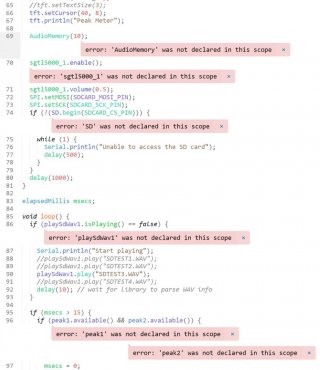

Src file of sketch :: T:\arduino-1.8.13_t54\hardware\teensy\avr\libraries\Audio\examples\Tutorial\Part_3_03_TFT_Display\Part_3_03_TFT_Display.ino
Compiling sketch...
"T:\\arduino-1.8.13_t54\\hardware\\teensy/../tools/precompile_helper" "T:\\arduino-1.8.13_t54\\hardware\\teensy\\avr/cores/teensy3" "T:\\TEMP\\arduino_build_314540" "T:\\arduino-1.8.13_t54\\hardware\\teensy/../tools/arm/bin/arm-none-eabi-g++" -x c++-header -O2 -g -Wall -ffunction-sections -fdata-sections -nostdlib -MMD -fno-exceptions -fpermissive -felide-constructors -std=gnu++14 -Wno-error=narrowing -fno-rtti -mthumb -mcpu=cortex-m4 -fsingle-precision-constant -D__MK20DX256__ -DTEENSYDUINO=154 -DARDUINO=10813 -DARDUINO_TEENSY32 -DF_CPU=96000000 -DUSB_SERIAL -DLAYOUT_US_ENGLISH "-IT:\\arduino-1.8.13_t54\\hardware\\teensy\\avr/cores/teensy3" "T:\\TEMP\\arduino_build_314540/pch/Arduino.h" -o "T:\\TEMP\\arduino_build_314540/pch/Arduino.h.gch"
"T:\\arduino-1.8.13_t54\\hardware\\teensy/../tools/arm/bin/arm-none-eabi-g++" -c -O2 -g -Wall -ffunction-sections -fdata-sections -nostdlib -MMD -fno-exceptions -fpermissive -felide-constructors -std=gnu++14 -Wno-error=narrowing -fno-rtti -mthumb -mcpu=cortex-m4 -fsingle-precision-constant -D__MK20DX256__ -DTEENSYDUINO=154 -DARDUINO=10813 -DARDUINO_TEENSY32 -DF_CPU=96000000 -DUSB_SERIAL -DLAYOUT_US_ENGLISH "-IT:\\TEMP\\arduino_build_314540/pch" "-IT:\\arduino-1.8.13_t54\\hardware\\teensy\\avr\\cores\\teensy3" "-IT:\\arduino-1.8.13_t54\\hardware\\teensy\\avr\\libraries\\ILI9341_t3" "-IT:\\arduino-1.8.13_t54\\hardware\\teensy\\avr\\libraries\\SPI" "T:\\TEMP\\arduino_build_314540\\sketch\\Part_3_03_TFT_Display.ino.cpp" -o "T:\\TEMP\\arduino_build_314540\\sketch\\Part_3_03_TFT_Display.ino.cpp.o"
Part_3_03_TFT_Display:19: error: 'AudioPlaySdWav' does not name a type
 AudioPlaySdWav           playSdWav1;     //xy=136,65
Part_3_03_TFT_Display:20: error: 'AudioAnalyzePeak' does not name a type
 AudioAnalyzePeak         peak2;          //xy=348,219
Part_3_03_TFT_Display:21: error: 'AudioAnalyzePeak' does not name a type
 AudioAnalyzePeak         peak1;          //xy=358,171
Part_3_03_TFT_Display:22: error: 'AudioOutputI2S' does not name a type
 AudioOutputI2S           i2s1;           //xy=380,92
Part_3_03_TFT_Display:23: error: 'AudioConnection' does not name a type
 AudioConnection          patchCord1(playSdWav1, 0, i2s1, 0);
Part_3_03_TFT_Display:24: error: 'AudioConnection' does not name a type
 AudioConnection          patchCord2(playSdWav1, 0, peak1, 0);
Part_3_03_TFT_Display:25: error: 'AudioConnection' does not name a type
 AudioConnection          patchCord3(playSdWav1, 1, i2s1, 1);
Part_3_03_TFT_Display:26: error: 'AudioConnection' does not name a type
 AudioConnection          patchCord4(playSdWav1, 1, peak2, 0);
Part_3_03_TFT_Display:27: error: 'AudioControlSGTL5000' does not name a type
 AudioControlSGTL5000     sgtl5000_1;     //xy=155,192
Part_3_03_TFT_Display: In function 'void setup()':
Part_3_03_TFT_Display:68: error: 'AudioMemory' was not declared in this scope
   AudioMemory(10);
Part_3_03_TFT_Display:69: error: 'sgtl5000_1' was not declared in this scope
   sgtl5000_1.enable();
Part_3_03_TFT_Display:73: error: 'SD' was not declared in this scope
Part_3_03_TFT_Display: In function 'void loop()':
Part_3_03_TFT_Display:85: error: 'playSdWav1' was not declared in this scope
   if (playSdWav1.isPlaying() == false) {
Part_3_03_TFT_Display:95: error: 'peak1' was not declared in this scope
     if (peak1.available() && peak2.available()) {
Part_3_03_TFT_Display:95: error: 'peak2' was not declared in this scope
Using library ILI9341_t3 at version 1.0 in folder: T:\arduino-1.8.13_t54\hardware\teensy\avr\libraries\ILI9341_t3
Using library SPI at version 1.0 in folder: T:\arduino-1.8.13_t54\hardware\teensy\avr\libraries\SPI
T:\arduino-1.8.13_t54\hardware\teensy\avr\libraries\Audio\examples\Tutorial\Part_3_03_TFT_Display\Part_3_03_TFT_Display.ino:70:17: error: 'AudioMemory' was not declared in this scope
   AudioMemory(10);

Audio code was copied from the :: T:\arduino-1.8.13_t54\hardware\teensy\avr\libraries\Audio\examples\Tutorial\Reference\Reference.ino
Opps - did not copy ::
#include <SerialFlash.h>
Getting Closer - it is choosing the adafruit sdFat-Beta in libraries now:
Multiple libraries were found for "Audio.h"
 Used: T:\arduino-1.8.13_t54\hardware\teensy\avr\libraries\Audio
 Not used: T:\tCode\libraries\Audio_-_Adafruit_Fork
 Used: T:\arduino-1.8.13_t54\hardware\teensy\avr\libraries\SD
 Not used: T:\arduino-1.8.13_t54\libraries\SD
Multiple libraries were found for "SdFat.h"
[B] Used: T:\tCode\libraries\SdFat_-_Adafruit_Fork[/B]
 Not used: T:\arduino-1.8.13_t54\hardware\teensy\avr\libraries\SdFat-beta
<EDIT> :: BUILDING NOW - need to open 64GB uSD card and get the files on it ...
