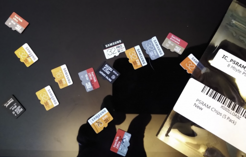

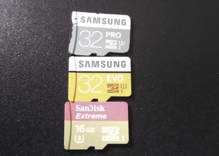

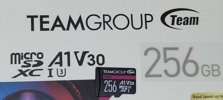

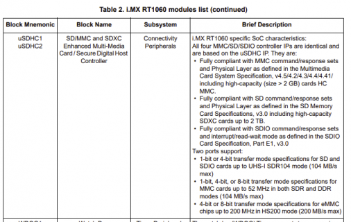

512GB and 1TB = very surreal. When I ordered the 512GB samsung was kind of nervous but worked, was nervous about the 1TB card.

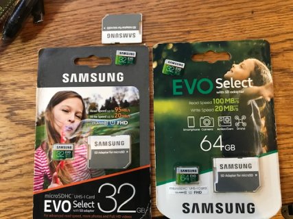

Together with the normal cards, I ordered one of the cheap no-name 512GB cards with the assumption it's really just 32 or 64 and would likely get corrupted if more is written. Last night I copied 390GB of MP3 files onto that card. Right now I'm listening to one of the first group copied. I'm still expecting the capacity claim to be a lie, but the fact that it's working at all seems pretty amazing!
Here are 2 different Amazon page with cards that look identical. Both seems to be EVO Select U1.
https://www.amazon.com/Samsung-Select-Memory-MB-ME32DA-AM/dp/B01DOB6Y5Q/
https://www.amazon.com/Samsung-MicroSDHC-Adapter-MB-ME32GA-AM/dp/B06XWN9Q99/

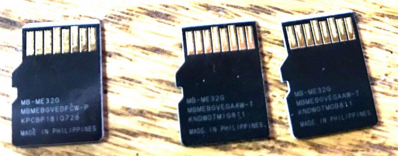

But one is part number "MB-ME32DA/AM", the other is "MB-ME32GA/AM". I have no idea if the "D" vs "G" is meaningful.
Any idea if the card you're using is either if "DA/AM" or "GA/AM", or maybe even a 3rd part number that also looks identical?
Just tested both chips on the T4.2 on the BuiltinSDCard and on the T3.2 with an external Card reader, both worked no problem. Also tested with an external card reader on a T4.0.
T4.1 on Internal Card Reader - Samsung EVO MB-ME32GA/AM

The CPU Spec sheet looks promising for even the higher UHS-1 spec
I've dug through the code and don't see any support for UHS-1. Would probably take a bit of work to do more than a hack job of it. Probably be a good "Feature Request'
From what I'm reading in the CPU specs and manual, That can be done using the SD/SDIO interfaces. Data sheets are here https://www.pjrc.com/teensy/datasheets.html
High level DataSheet: https://www.pjrc.com/teensy/IMXRT1060CEC_rev0_1.pdf
Deep dive Manual: https://www.pjrc.com/teensy/IMXRT1060RM_rev2.pdf
From page 1376 of the processor manual
2[B][I]4.3 eMMC/eSD/SDIO[/I][/B]
This chip has two Ultra Secured Digital Host Controller (uSDHC) modules for SD/
eMMC interface. It provides the interface between the host system and the SD/
SDIO/MMC cards.
The key features include:
• Support SD/SDIO standard, up to version 3.0
• Support MMC standard, up to version 4.5
• Support 3.3V and 1.8V operation, but do not support 1.2V operation.
• Supports 1-bit / 4-bit SD and SDIO modes, 1-bit / 4-bit / 8-bit MMC modes
• Up to 800 Mbps of data transfer for SDIO cards using 4 parallel data lines in
SDR mode
• Up to 400 Mbps of data transfer for SDIO card using 4 parallel data lines in
DDR mode
• Up to 800 Mbps of data transfer for SDXC cards using 4 parallel data lines in
SDR mode
• Up to 400 Mbps of data transfer for SDXC card using 4 parallel data lines in
DDR mode
• Up to 1600 Mbps of data transfer for MMC cards using 8 parallel data lines in
SDR mode
• Up to 800 Mbps of data transfer for MMC cards using 8 parallel data lines in
DDR mode
eMMC/eSD/SDIO
[B]i.MX RT1060 Processor Reference Manual, Rev. 2, 12/2019
1376 NXP Semiconductor[/B]
EDIT: So full UHS-1 support "should" be possible on the T4.0 and T4.1 as long as the SD card is connected to one of the two SDIO interfaces.
EDIT2: There is also a whole section on setting up SD/SDIO boot with UHS-1 support....
EDIT3: On the T4.0, you need to use the SD Card (4 bit SDIO) flats on the bottom of the board and an SD card Connector/module with NO level converters.
https://www.digikey.com/en/products/detail/molex,-llc/5031821852/5823232 or https://www.digikey.com/en/products/detail/molex/0475710001/3262277

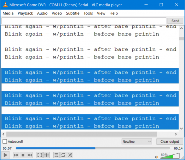

Here is my latest attempt to fix the double spaced lines on copy to clipboard from the serial monitor on Windows.
Extract this zip file and copy teensy_serialmon.exe to {Arduino}/hardware/tools, replacing the existing file. Windows probably won't let you replace it if the serial monitor is open. The default Arduino location is C:\Program Files (x86)\Arduino.
I ran a quick test here on Windows 10 where it seems to work. Does this solve the double spaced lines on your Windows machine?
  • teensy_serialmon_windows.zip
@Paul - that works here on Windows 10:
 Blink again - w/println - before bare println
 Blink again - w/println - after bare println - end loop.

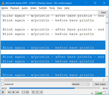

<EDIT> :: This is NOT new behavior - just put back another copy of that file from another 1.54 beta install - and it has the same ODD behavior
Note: Text select to copy does odd shift of selected text - rather than inverse text color on highlight and stay steady - some lines toggle inverted text color to not visible?
Movie too big - here are three frames ...
