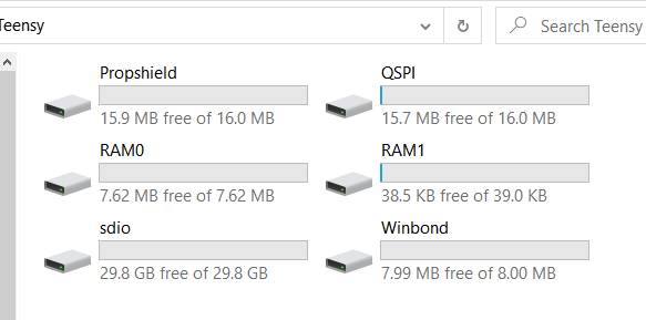

Test sketch LFSintegrity built and runs fine on RAM [EXTMEM] as last run. No warnings or errors.
Installed, updated MTP removed other mtp.. built, nothing showed up on pc. Figured out I did not have so on pin 4, commented that out and now all the others show up :D

Tested MTP on beta5, seems to work.
Note: for using USB_MTPDISK_SERIAL one has to a) copy file contents into different usb_desc.h and boards.txt
Native MTP mode uses SEREMU and not Serial
If using T4 one needs USB2 from same github
