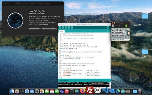

The latest big sur 11.1 update doesn't load the teensyloader, it's also still crashing when opening arduino, but works on reload..it was doing this before but now as i said won't lode the loader?
What is that? Always that Apple Extra! Catalina solved, Big Sur on. Would it be rude to drop Mac support altogether to keep the development going? There need to be many and strong signals towards Cupertino!
ed: btw, i've recycled my Mac, because it was getting on my nerves with Catalina already.
Apple users can still use one of the existent Windows or Linux VM solutions.
You can not burden a similar requirement onto people using a functional OS!
This completely arrogant Apple-tude needs to be grounded once, and hopefully forever.
At the End it is good, Apple reverts to console chips, showing their true colours.
There is no reason why a hold on Mac support has to be eternal. Once the Costermongers change their strategy from sucking and bullying users to making a working functional system, Mac support might be considered again.

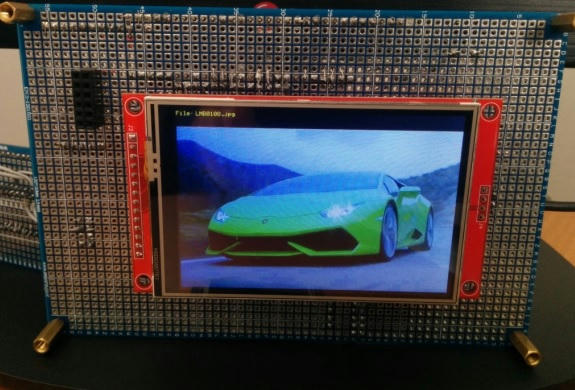

I am getting familiar with the ILI9488_t3 library and the settings to SdFat. Today I was reviewing the JPEGDEC library; To migrate the old projects to the new screen, I was compiling some examples that worked well in the IDE 1.8.13 with the Teensy Loader 1.54-beta3.
Now with the Teensy Loader 1.54-beta5 only errors jump like rabbits!
C:\arduino-1.8.13\hardware\teensy\avr\libraries\SD\src/SD.h:159:49: error: 'FILE_READ' was not declared in this scope
  File open(const char *filepath, uint8_t mode = FILE_READ) {
C:\arduino-1.8.13\hardware\teensy\avr\libraries\SD\src/SD.h: In member function 'virtual File SDClass::open(const char*, uint8_t)':
C:\arduino-1.8.13\hardware\teensy\avr\libraries\SD\src/SD.h:161:15: error: 'FILE_WRITE' was not declared in this scope
   if (mode == FILE_WRITE) flags = O_RDWR | O_CREAT | O_AT_END;
JPG_decoder: In function 'void* myOpen(const char*, int32_t*)':
JPG_decoder:5: error: call to 'virtual File SDClass::open(const char*, uint8_t)' uses the default argument for parameter 2, which is not yet defined
   myfile = SD.open(filename);
SliderJPG: In function 'void loop1()':
SliderJPG:5: error: call to 'virtual File SDClass::open(const char*, uint8_t)' uses the default argument for parameter 2, which is not yet defined
   File dir = SD.open("/");
Is the JPEGDEC library still compatible with the settings made to SdFat (formerly SdFat beta)? .

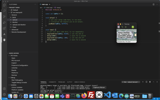

Can't confirm. Had Teensyduino crashing once on opening, but that problem disappeared after a reboot. Now opens consistently and launches the teensy loader as expected :
Edit: Teensy loader can also be launched without problems from PlatformIO, still in Big Sur 11.1 beta :
I was able to reproduce this problem. It's a bug in the new SD.h, where it's a bit too aggressive about undefining the incompatible FILE_READ and FILE_WRITE from SdFat.h. When headers are included in an unexpected order, as the JPEGDEC example does, SD.h was undefining the correct values, and then FS.h was not redefining them because it had already been included. That causes code elsewhere in SD.h to not compile because we undefined them, expecting FS.h to define them properly.
I've committed a fix on github.

I'm absolutely not going to drop Macintosh support. Anyone who's worried by the talk on this thread can consider can this message to be official word from PJRC. Mac support will continue. No need to worry - stand down from Red Alert. ;)
But seriously, I'm usually only able to fix problems I can reproduce one 1 of my 5 Macs (an old 11 inch Macbook Air, a 13 inch Macbook Air, a "trashcan" Mac Pro, and a really slow Mac Mini, and a very old 17 inch Macbook Pro). Currently those 5 machines have 10.7, 10.12, 10.13, 10.14 and 10.15 installed. I'm currently running a Time Machine backup on the 13 inch Macbook Air, which is the one with 10.15 Catalina installed. It's also the newest of my machines, from 2015. Later today I'll update it to Big Sur. This means I won't be able to test Catalina, unless I update one of the other machines or find a way to revert this machine.
FWIW, even though I haven't bought a Mac for 5 years, I do have 5 of them sitting around. I'm planning to get a 6th Mac with the new M1 chip, but hoping to wait until Apple releases a faster version with more RAM.
I'm guessing my Big Sur experience will be similar to what Theremingenieur showed, partly because Big Sur has been out for a while and this is only the first report of it not working. If it does work when I test, of course I'll give you a screenshot, and you can take that to mean I probably won't be able to resolve the problem unless you give my a *lot* of info that's often hard to find with Macs (and even then, odds are slim I'll figure it out from only tech info). If I can reproduce the problem, of course I'll work on a fix!
On the Big Sur issue, please check the System Preferences > Security & Privacy settings. First look at "Files and Folders" to check whether you've (perhaps unintentionally) disallowed the software to access files it needs.
This is a known issue on Catalina, where disallowing access to Documents causes the software to be unable to start up.
https://www.pjrc.com/teensy/td_download.html#mac_documents_folder
Maybe also look through the many other types of access on the left side column and check whether Teensyduino or Arduino or Teensy Loader are listed in any of them. Apple may have added more types of privacy restrictions in Big Sur, where disallowing access has (so far) unknown effects on the software. We do know 100% for sure that disallowing Documents causes Teensyduino to quit before it can fully start up, so these sorts of privacy restrictions can be a real problem if something the software needs is restricted.

I put these lines at the beginning of the SD.h file:
// Use FILE_READ & FILE_WRITE as defined by FS.h
//#ifdef FILE_READ
#if defined(FILE_READ) && !defined(FS_H)
#undef FILE_READ
//#ifdef FILE_WRITE
#if defined(FILE_WRITE) && !defined(FS_H)
#undef FILE_WRITE
#include <FS.h>
Now both libraries: SD and JPEGDEC can coexist without problems.
Teensy 4 + ILI9488 3.5" + SD + JPEGDEC
Thanks for the prompt response.
