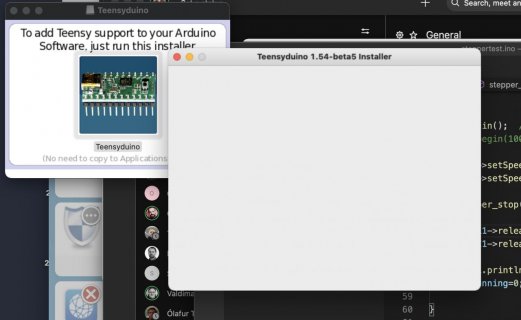

not sure if this is known issue, or not - I upgraded to BigSur on Macbook pro 2018
I recently started using VS Code with the Arduino expansion, but I have not been using Teensy in the projects up to now, but I now need Teensy and ran into this issue.
...So you can perhaps just stop me if the VSCode+Teensy will work or not.
I started with root and tried some command line hacks , If I click around the grey area I hit some buttons, at least cancel ;
