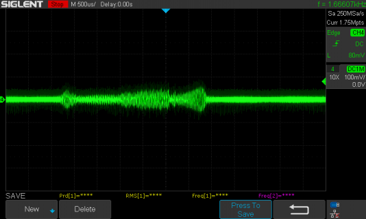

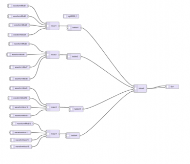

AUDIO Library : Ladder filter degrades signal/noise ratio ?
... not sure where to post this one which relates to the audio library new ladder filter.
I am using 16 Waveform oscillators routed to 4 ladder filters.
When turning on the oscillators (amplitude > 0.f) a fixed frequency noise (NOT the oscillators frequency) is generated to the line output even when input/output mixers are set with a gain of 0.
This does not happen if no ladder filter is present.
Teensy 4.0 / Audio Rev D

If all the output mixer gains are set to zero there should be silence. If not perhaps there is a shortage of Audio buffers or CPU time?
The ladder filter is expensive in CPU time as it has to do rate conversion.
Just added audio processor and memory measures :
20:10:11.806 -> | Processor Usage = 16.66 | Memory Buffers Usage = 16 |
20:10:12.807 -> | Processor Usage = 16.66 | Memory Buffers Usage = 1 |
20:10:13.840 -> | Processor Usage = 16.66 | Memory Buffers Usage = 16 |
20:10:14.810 -> | Processor Usage = 16.66 | Memory Buffers Usage = 1 |
If the digital stream is not stuttering and is all zeros, what remains can only be noise on the supply rail getting into
the analog output. This noise will be pattern sensitive and could conceivably be only audible in some configurations
of the audio objects.
The audio shield in particular doesn't have separate analog and digital grounds and supplies.
Thanks for the advice... however, this shows an important limit for its use... meanwhile I will try to investigate further (checking the audio stream, reduce the configuration). Any suggestions welcome!
Lionel
Just tried with a SINGLE ladder filter with 4 osc. The issue is still alive and the same fixed frequency is still audible - though attenuated -...
I don't know how to reliably check the contents of the digital stream...

  oscillators[0].osc = &waveformMod1;
  oscillators[1].osc = &waveformMod2;
  oscillators[2].osc = &waveformMod3;
  oscillators[3].osc = &waveformMod4;
  mixer1.gain(0, 0);
  mixer1.gain(1, 0);
  mixer1.gain(2, 0);
  mixer1.gain(3, 0);
  for (int i = 0; i < 4 ; i++) {
    oscillators[i].osc->begin(0.5f,440.f, WAVEFORM_SINE);
  sgtl5000_1.enable();
  sgtl5000_1.lineOutLevel(13);
  sgtl5000_1.autoVolumeDisable();
  sgtl5000_1.audioProcessorDisable();
  static bool toggle = false;
  toggle = (toggle)?0:1;
  float oscAmp = (toggle)?0.1:0.0;
  for (int i=0; i< 4 ; i++) {
    oscillators[i].osc->amplitude(oscAmp);
  Serial.println("| Processor Usage = " + String(AudioProcessorUsageMax()) + " | Memory Buffers Usage = " + String(AudioMemoryUsageMax()) + " |");
  AudioMemoryUsageMaxReset();
  AudioProcessorUsageMaxReset();

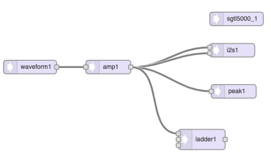

2.1 - Using waveform -> amp -> ladder
The peak is stable and the result is as follows :
18:41:39.922 -> Peak with osc Amplitude set to  : 0.10 => 1.00003052
18:41:40.920 -> Peak with osc Amplitude set to  : 0.00 => 1.00003052
18:41:41.940 -> Peak with osc Amplitude set to  : 0.10 => 1.00003052
18:41:42.948 -> Peak with osc Amplitude set to  : 0.00 => 1.00003052
The sketch does not generate unwanted noise.
No fixed frequency noise from Ladder filter : Expected behaviour.

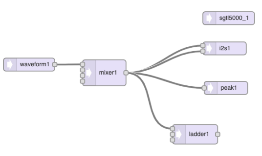

2.1 - Using SAME code with a mixer in place of the amp :
(All the mixer gains are set to 0.f)
The result is :
18:51:48.823 -> Peak with osc Amplitude set to  : 0.00 => 1.00003052
18:51:49.838 -> Peak with osc Amplitude set to  : 0.10 => 0.00000000
18:51:50.837 -> Peak with osc Amplitude set to  : 0.00 => 1.00003052
18:51:51.854 -> Peak with osc Amplitude set to  : 0.10 => 0.00000000
18:51:52.838 -> Peak with osc Amplitude set to  : 0.00 => 1.00003052
18:51:53.826 -> Peak with osc Amplitude set to  : 0.10 => 0.00000000
We can see a peak change every second AND a (ladder filter) unwanted fixed frequency noise can be heard.

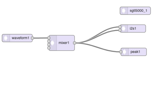

#include <SerialFlash.h>
AudioSynthWaveform       waveform1;      //xy=770,348
AudioMixer4              mixer1;         //xy=943,367
AudioOutputI2S           i2s1;           //xy=1219.8333740234375,310.66668701171875
AudioAnalyzePeak         peak1;          //xy=1223,402
AudioConnection          patchCord1(waveform1, 0, mixer1, 0);
AudioConnection          patchCord2(mixer1, 0, i2s1, 0);
AudioConnection          patchCord3(mixer1, 0, i2s1, 1);
AudioConnection          patchCord4(mixer1, peak1);
AudioControlSGTL5000     sgtl5000_1;     //xy=1229.3333129882812,241
  AudioMemory(15);
  waveform1.frequency(440.f);
  waveform1.amplitude(0.f);
  mixer1.gain(0,0.0f);
  mixer1.gain(1,0.0f);
  mixer1.gain(2,0.0f);
  mixer1.gain(3,0.0f);
  static float oscAmp = 0.f;
  Serial.println("Peak with osc Amplitude set to  : "+ String(oscAmp) + " => " + String(peak1.read(),8));
  waveform1.amplitude(oscAmp);
This looks strange (as the code for Mixer and Amp look very similar)...

You're results from peak1.read() are spurious unless you first check peak1.available().
I've had a play with the example and I see only zeroes coming out - this is likely EMI on the rails therefore.
I double checked by hooking my 'scope to the LRCLK1 and OUT1A I2S pins and confirmed all zeros are
being sent.
I couldn't hear anything on the headphone output other than very low level noise that I'd expect, but I did
pick up some odd occasional glitches on the line out every few seconds, which seem to be ultrasonic:
This might be a red herring I suppose, perhaps some artifact of the SGTL5000 noise-shaping.
I am wondering how you have your audio ground set up for listening to the line-out signals - there's
plenty of scope for accidentally having a ground-loop which could explain the noise break-through.
