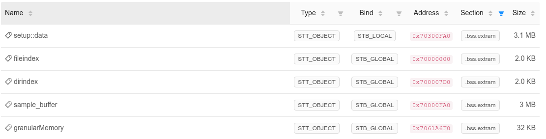

Its allready for a long time possible to get more info on the allocated memory during compilation,
just add this to platformio.ini
Memory region Used Size Region Size %age Used
ITCM: 151036 B 512 KB 28.81%
DTCM: 123584 B 512 KB 23.57%
RAM: 15424 B 512 KB 2.94%
FLASH: 325 KB 7936 KB 4.10%
ERAM: 6432512 B 16 MB 38.34%
Checking size .pio/build/teensy41/firmware.elf
Advanced Memory Usage is available via "PlatformIO Home > Project Inspect"
RAM: [===== ] 52.4% (used 274608 bytes from 524288 bytes)
Flash: [ ] 3.7% (used 299336 bytes from 8126464 bytes)
teensy_size .pio/build/teensy41/firmware.elf
teensy_size: Memory Usage on Teensy 4.1:
teensy_size: FLASH: code:179364, data:144836, headers:8596 free for files:7793668
teensy_size: RAM1: variables:123584, code:151032, padding:12808 free for local variables:236864
teensy_size: RAM2: variables:15424 free for malloc/new:508864
teensy_size: EXTRAM: variables:6432512
