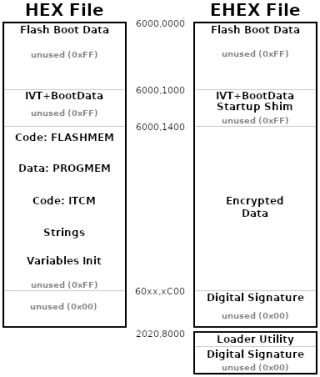

Again I could be completely out to lunch ;)
But I am wondering if this code in usb.c may have something to do with it:
FLASHMEM void _reboot_Teensyduino_(void)
	if (!(HW_OCOTP_CFG5 & 0x02)) {
		asm("bkpt #251"); // run bootloader
		__disable_irq(); // secure mode NXP ROM reboot
		USB1_USBCMD = 0;
		IOMUXC_GPR_GPR16 = 0x00200003;
		// TODO: wipe all RAM for security
		[COLOR="#FF0000"]__asm__ volatile("mov sp, %0" : : "r" (0x20201000) : );[/COLOR]
		__asm__ volatile("dsb":::"memory");
		volatile uint32_t * const p = (uint32_t *)0x20208000;
		*p = 0xEB120000;
		((void (*)(volatile void *))(*(uint32_t *)(*(uint32_t *)0x0020001C + 8)))(p);
	__builtin_unreachable();
Again maybe totally off, but...
It looks like it is setting up a pointer to allow for a 4K stack...
Again for what it is worth, I added two buffers... And second one was not mucked with...

Press any Key to reboot the Teensy
Now Resetting
Simple DMAMEM startup memory test
*** At Startup ***

After that is a call to the i.mx.rt bootloader.. whatever this does. Possible, that this call configures or deletes something.
The NXP flashloader API is described in a document in a zipfile named FLASHLOADER-RT106x-1-GA.zip (it has some tool also, i.e. for encryption (windows, linx, mac))
(edit: the sourcecode for blhost is here: https://www.nxp.com/webapp/sps/down...e=blhost_2.6.7&appType=file1&DOWNLOAD_ID=null)
2021-08-22 14_54_40-MCU Flashloader Reference Manual.pdf - Adobe Acrobat Reader DC (32-bit).png
But I couldn't find a source where the API<--> adresses are described. It must exist somewhere..
