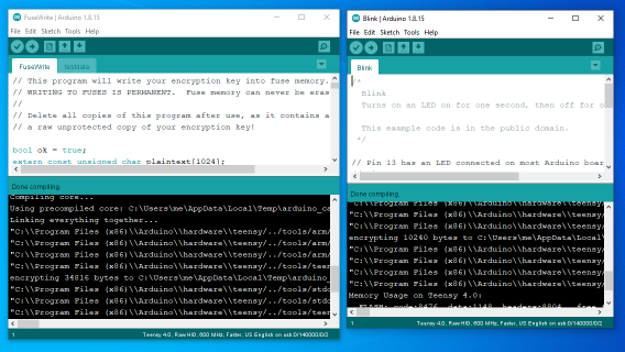

So after FuseWrite and VerifyEncrypted buttons the steps have to be to load an encrypted sketch:
[B]Step 1. Verify sketch
Step 2. File -> Open Hex File -> Arduino Build folder and open ehex file created in Step 1 (Verbose will give you the location)
Step 3. Hit PGM button on the Teensy[/B]
Not sure. What I did was open a different sketch with the pem.key file in the Arduino Directory. Compile verbose showed:
"F:\\arduino-1.8.15\\hardware\\teensy/../tools/teensy_secure" encrypthex TEENSY40 "C:\\Users\\Merli\\AppData\\Local\\Temp\\arduino_build_228995/uncannyEyes_async_st7789_240x240.ino.hex"
No key .pem file found, skipping .ehex encryption
It's always supposed to run teensy_secure to create .ehex if you have key.pem in the right place.

@Paul - in Teensy_Loader where filename is shown. With IDE Upload do you see .hex or .ehex?
Here on standard Upload I only ever get .hex - and as shown in Verbose above that seems to be what transfer by default.
Seems the same for Mike - only way to have eHex sent is to manually open the file and select it. Then as noted above p#13 the verbose indicates some hiccups - error and dislikes ELF.
So it looks like if there is no valid ehex file in the builder folder then it will just use the .hex, if not it uses the ehex - I think???????
For 1.55-beta2, looks like I need to add more explicit statements about which file Teensy Loader is actually using.
It's giving that info now, but it's not strongly worded and in the verbose info it's mixed together with lots of other messages regarding detection of which board, communication of update from Arduino, etc. The info is lacking a clear and unmistakable message about which file is actually being used.
This is the line which inadequately tells which file Teensy Loader is actually using.
11:49:01.838 (loader): using encrypted ehex (optional - secure mode not yet locked)
But this line can change into many different messages, like "no valid ehex file, use hex" or "using hex file - Teensy not configured for encryption" depending on the circumstances that caused Teensy Loader to choose the .hex file rather than .ehex.
For 1.55-beta2 I will add a more definitive message.

If you open a .hex file, or if Arduino tells Teensy Loader about a new .hex file, Teensy Loader will automatically look for a matching .ehex files and maybe use it instead of the .hex file.
This is meant to be convenient and automatic, but yes, it is confusing if you want to know which file is actually being used. This is exactly the sort of thing we're looking for in this beta test (well, and also anything which completely bricks a lockable board). For 1.55-beta2 I'll work on making better visible feedback on whether the .ehex or .hex file is actually being used.
However, if you open a .ehex file (which can only be done from File > Open - never by Arduino), the reverse is not true. Teensy Loader will only use the .ehex file and not automatically look for a .hex.
But it seems another bug exists (this is still beta, afterall) where explicitly opening a .ehex file and then programming a board which can't use .ehex is causing Teensy Loader to erase and then not program anything. That's definitely wrong behavior. It should know that no .hex file was actually loaded and refuse to start the programming process, because it will always result in an unbootable Teensy which needs a button press to recover.
Another bug I will fix in 1.55-beta2.
