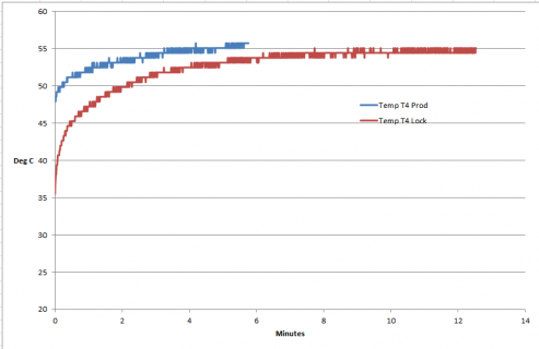

Kitchen with modified loop:
  //float testTemp = tempmonGetTemp() - myTemp;
  Serial.print((millis()-time_now)*0.00001667,4);Serial.print(", ");
  Serial.println(tempmonGetTemp(),2);
Both T4's running the same sketch. One teensy 4 is a production T4 at version 1.05 the other is the locked T4 at version 1.07 basically just getting the temperature. Power was not measured.
EDIT: Not sure what to try next.

That doesn't match what I saw - maybe the PROD T4 I have is different gen than what is there? Can you measure current ... would take me like 5 minutes to get a crude DMM reading on mine.
That is Kitchen pre-LFS ... the LFS add halts temp check while idle waiting for input ... I should post that version too ... or you could Mike.

Yep using the pre-LFS test sketch. Here is what I used for temp measurement on both boards

DMM showing this for current idling running the posted SINK sketch:
#1 - Production T4_1.05 - bare board :: 98mA-99mA : 48 °C
#2 - Unfused T4_1.07 in T4 PJRC Beta breakout :: 109 mA (powering breakout LED and other on the board?) : 59 °C
#3 - Fused T4_1.07 with key.pem - bare board :: 99 mA-100 mA : 55 °C
Not sure why #'s 1 and 3 can be so close and the temp read so diff is 1 mA that much extra heat?
Next step would be external measure - but that is more arbitrary ...

The 55-56 is about what I got for the key.pem board in my breakout board that I did for the T4 a long time ago. Not sure why you are only seeing 48 degC on the bare T4 production board.

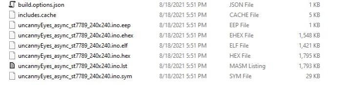

So it creates two hex files: screenshot.jpg
So the two files *.hex and *.ehex
Have different sizes (and likewise contents)
For example they both start with the first same line but diverge quickly and their endings are completely different>

So question to myself and others who hopefully can answer it and/or beet me to it.
Does both the HEX file and EHEX file take up the same space on flash memory?
That is do we have the same space left in both cases for a possible LittleFS FS?
Kurt
I'm starting work on documentation. Or at this point mostly just an outline, but it's a start. I hope to fill it in soon. I'm planning a lengthy section to document EHEX details.
There are 2 things to know about the EHEX file size.
First, it is actually 2 programs concatenated together. For example, you should see something like this near the end of the file:

The .ehex file has 32 data bytes on every line. But the .hex file created by the compiler sometimes as 16, sometimes 32, sometimes other amounts. Because every line has 11 chars (plus NL or CR+NL) overhead, it's difficult to compare file sizes when the data bytes per line are different. Fewer lines with more data per line means less overhead.
Yes. The .HEX and .EHEX are exactly the same number of data bytes, if you ignore the 2nd portion of the .EHEX (which is uploaded to RAM, not to flash and doesn't become part of your program).
You should see nearly identical data from 60000000 to 600013FF, except that a small chuck of data is added at 60001030. This is a startup shim which turns on the Bus Encryption Engine. It basically just loads a 96 bit nonce number into the BEE registers (all symetric ciphers using CTR mode require a nonce), configures the address range, turns on the hardware, and then jumps to the beginning of your program inside the now-decrypted address range.
60001400 to the CSF location is encrypted. If you compare data, it should look nothing alike. In the .HEX file, you'll see the end of your program is padded with FF bytes until the CSF placeholders, which is all 00 bytes. When you look at the same addresses in the .EHEX, you'll see everything up to the CSF area including those 0xFF padding bytes has been encrypted. You'll also see the CSF signature has been written where the original .HEX at 3072 zeros as a placeholder. The first 4 bytes of every CSF generated by the teensy_secure utility should be D4, 00, 30, 40. If you create a CSF with NXP's CST program, you should always get D4 as the first byte, but the others could differ depending on a lot of things.
If you scroll through the CSF data, you'll see some of the 3072 zero bytes remain. With the key sizes and other factors we're using, the CSF always fits within 3K, but its exact size can't be perfectly predicted. I'm sure NXP's CST utility can generate longer CSF data in certain very complex usages, but the way we're doing things on Teensy the 3K placeholder should be enough.
Yes. The program image is always precisely the same size. The CSF signature and startup shim are added in zero padded spaces that are known to always exist (at least in HEX files created using the 1.55-beta1 linker scripts). The AES encrypted data is always exactly the same size as the original plaintext.
