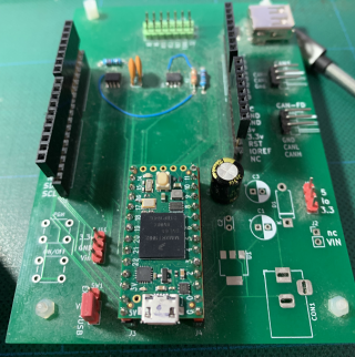

Downloaded, installed over 1.8.16, verified the test program for ST7735 runs on T4 (lockable not locked)
05:57:06.888 (loader): using encrypted ehex (optional - secure mode not yet locked)
05:57:06.930 (loader): begin operation
05:57:06.949 (reboot 8): Status: 1, 1, 1, 1, 0, 1, C:\Users\kurte\AppData\Local\Temp\arduino_build_190887\, graphicstest.ino.hex

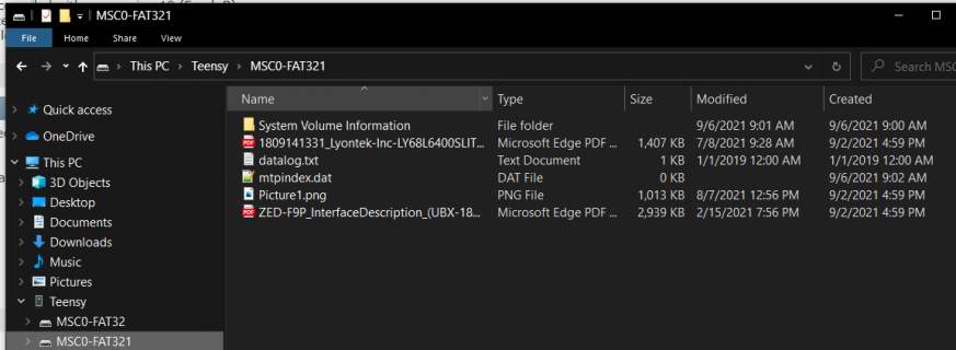

Updated FS.h, SD.h to include the addition of FS-dates as well as updating SDFat to MAINTAIN_FREE_CLUSTER_COUNT.
Ran a test USB_MTP_Datalogger example that Kurt and I was working on to test memory sticks on the locked T4. So using a 64GB stick I compiled and loaded it 10x to try and duplicate @defragster's issue in post https://forum.pjrc.com/threads/67989-Teensyduino-1-55-Beta-1?p=287847&viewfull=1#post287847. RESULTS: No issues with the Dual LEDS or sketch hanging on upload or not loading.
As for the MTP-USB test this is the windows explorer:
