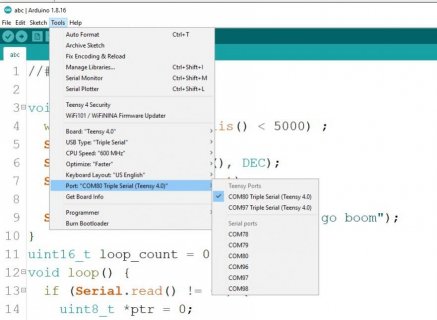

@Paul
Finally after I don't know how many uploads I finally ran into the issue with the dual LEDs blinking on an upload with the Arduino IDE using the locked T4. As @defragster and @KurtE mentioned after maybe 10seconds it did reset/upload (sorry forgot been distracted today) without any intervention on my part and the sketch ran normally.
@Paul
On revisit to Beta 1 thread - with Beta 2 installed - it was noted running a trivial KurtE sketch I triggered the DUAL LEDS on button push. Tried then repeating steps it seemed led to it and it didn't show.
I did see the 'TyComm Reset' over USB trigger Teensy Loader to do the reported false Upload start and fail - which seems only to happen first time after an Upload. Again 'feeling' is Teensy Loader or something is holding 'state' from prior upload when triggered by 'USB Reset' it acts based on 'state' of prior operation? Not sure if that might be causing the DUAL LEDS where a valid Button upload isn't starting from 'clean slate/state'?

Paul, Not sure if this has been mentioned and/or has been covered somewhere... Sometimes I also lose the trees in the forest :D
Should a locked T4 act differently then a normal older T4 when you press the program button and the Teensy app is not running yet... I was testing a few of the different USB modes yesterday to see if the issue of Serial Terminal not coming back after crash would reproduce on a USB mode that ships with Teensyduino... So I have a couple of different T4s to try to see if it makes any differences of locked versus unlocked...
What I noticed is that the two boards act differently when I press the program button and I don't have the Teensy app running...
That is: I have two running now with Triple Serial (last one I tried):
So I startup the Arduino App, and have the two Teensy boards running as you can see:
I now press the program button on both boards.
When I do it with the older non-locked T4 it resets, the program led stays lit and waits to be programmed. It also shows up in the Arduino Ports list with the type...
If I do that with the Locked T4, I hear a beep, but program LED does not come/stay on... Also the Teensy no longer shows up int he ports list of Arduino.
In this bogus case I pressed it on both Teensy boards in previous picture:
Again sorry if covered before... But thought I would mention it before I get the next cup of coffee to fully wake up.
Yes, this is the correct behavior for a board locked into secure mode.
When you press the button on a locked Teensy, it runs NXP's ROM only. Teensy Loader and the "loader utility" part of a EHEX file are needed to get it into bootloader mode.
If Teensy Loader isn't running, or if Teensy Loader hasn't opened a EHEX file (opening a HEX file automatically also opens the corresponding EHEX file), or if the EHEX file it has opened was created with the wrong encryption key, then the hardware just sits there unable to do anything. It can't even turn on the red LED.
I tried to make the user experience as similar as I could. This part is unavoidably different due to the way the chip's HAB security features work.
