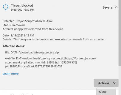

Here is an attempt to fix the bug where upload sometimes fails (if the pushbutton is pressed again) resulting in both LEDs blinking for several seconds.
Extract this to {Arduino}/hardware/tools, replacing the copy already installed.
My machine refused : "couldn't download - virus detected"?
Found offending page and hit allow and next try saved:
Scan with Windows Defender and MalWareBytes find nothing - But EDGE wanted to trash it?
