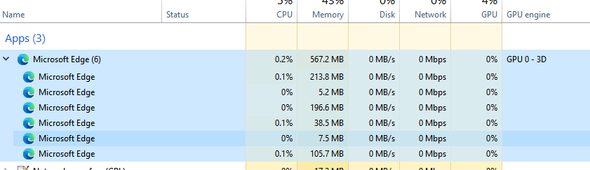

Edge and 'browser' indeed.
Have 7 instances of EDGE open here with some large number of tabs - TaskMan shows (50) subtasks.
Funny of PowerShell and both command Processors are their own entry - but definitely running on ONE CORE. Pausing the first two dropped ~10% each then ~30% for the final - leaving some 10% on that core as before.
Two glitched and restarted the third dumped this - passed the "Q" uick print and then hung in the "-X_" recovery over a minute ago with this - showing computer make/model:

Interesting NOTE: return to TaskMan - CPU Perf. That ONE CORE now running at 60% KERNEL TIME ( IT WAS ALL KERNEL time before ) - but now has APP time over Kernel time at 90% with regular peaks toward 100% on that core.
> maybe the INTEL CPU only has USB connectivity on that first CORE?
