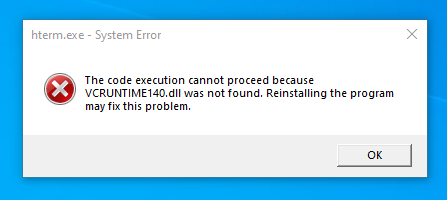

I downloaded Hterm, but it wants various DLLs my Windows test system doesn't have.

Maybe Defragster can send you the missing DLLs. For me, it worked out of the box.
I got Hterm to run after installing VC_redist.x64.exe downloaded from this Microsoft page.
But then it gave me the same problems Defragster saw.

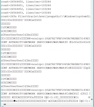

Your monitor shows garbage, the original gets stopped and the whole task deleted (by windows?), hterm shows a hourglass and gets stopped after a while, too.

I did see garbage in Coolterm (which only manages several thousand lines/sec speed). Haven't seen anything bad fly by in the Arduino serial monitor yet, but it's only been running for maybe 10 minutes so far.

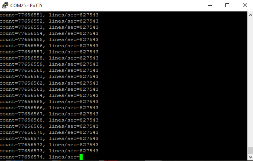

The windows port of Putty shows this (with garbage)
And wow, it skips "a few" lines :
count=10000776, lines/se0
count=10015316, lines/sec=0

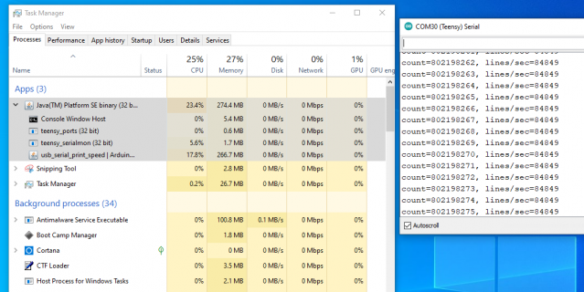

Running that code seeing about 75K lps consistently with TyComm {not over 90K} - then some few minutes and 'SPLASH' of a full screen of garbage.
Moving to teensy_serialmon: Cycles typically between ~(75K to 155K) lps
> drops to 1 lps on (rare) occasion. Rare under 50M cnts, then more often as it neared/passed 100M
>> over 100M cnts seeing cycling of 1 lps (for 1-3 sec and pulse to 180K lps)
>> FIRST STALL at : count=122247991, lines/sec=1 : Recovery? - No :: Until I hit 'Send' { repro again at ~128M cnts }
> not caught garbage yet
> see only sub second GUI pauses that are rare

I have seen garbage text using provided 'available' code:

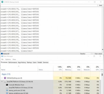

Using IDE gets really sluggish, or non-responsive, at times when the t_sermon gets troubled, and fine other times while running.

Just saw Garbage go by and while it was drawing the USB1 port from TyComm output response to USB1 input was delayed until the garbage cleared?

Garbage repeated again with the delayed response during t_sermon garbage display - almost as if at that
