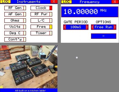

You may be interested in this montage showing the project I have been working on for over a year now and would benefit from a solution to this problem.
Best regards,
RichardL
